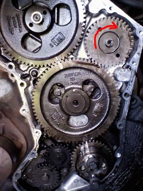

Does anyone have any pics of the front of the engine with the cover removed? I'm really having trouble wraping my brain aroun what I need to do to advance my timing 1 tooth. I think its because I've never had my cover off and the few pics I havve seen I never paid attention too. just trying to get a game plan together.
Thanks Guys!

Thanks pete, I found one, so if I'm thinking correct I need to pull the front cover, pull this gear and rotate it and teh pump shaft one tooth clockwise. Correct? I still dont understand why I'm having issues with this. :lol:

RSWORDS wrote:Thanks pete, I found one, so if I'm thinking correct I need to pull the front cover, pull this gear and rotate it and teh pump shaft one tooth clockwise. Correct? I still dont understand why I'm having issues with this. :lol:
Just so it's been said, the gear with the red arrow is in fact the accessory drive gear for the vacuum pump / power steering.
The gear for then IP is the big one at the top of the image. ;)

Postby PToombs » Fri Jun 19, 2009 6:11 pm
Yeah Bobby. Clockwise is the hot ticket. I had to look at it and think about it 3 times before I was sure. :oops: I need more beer too! ;)
