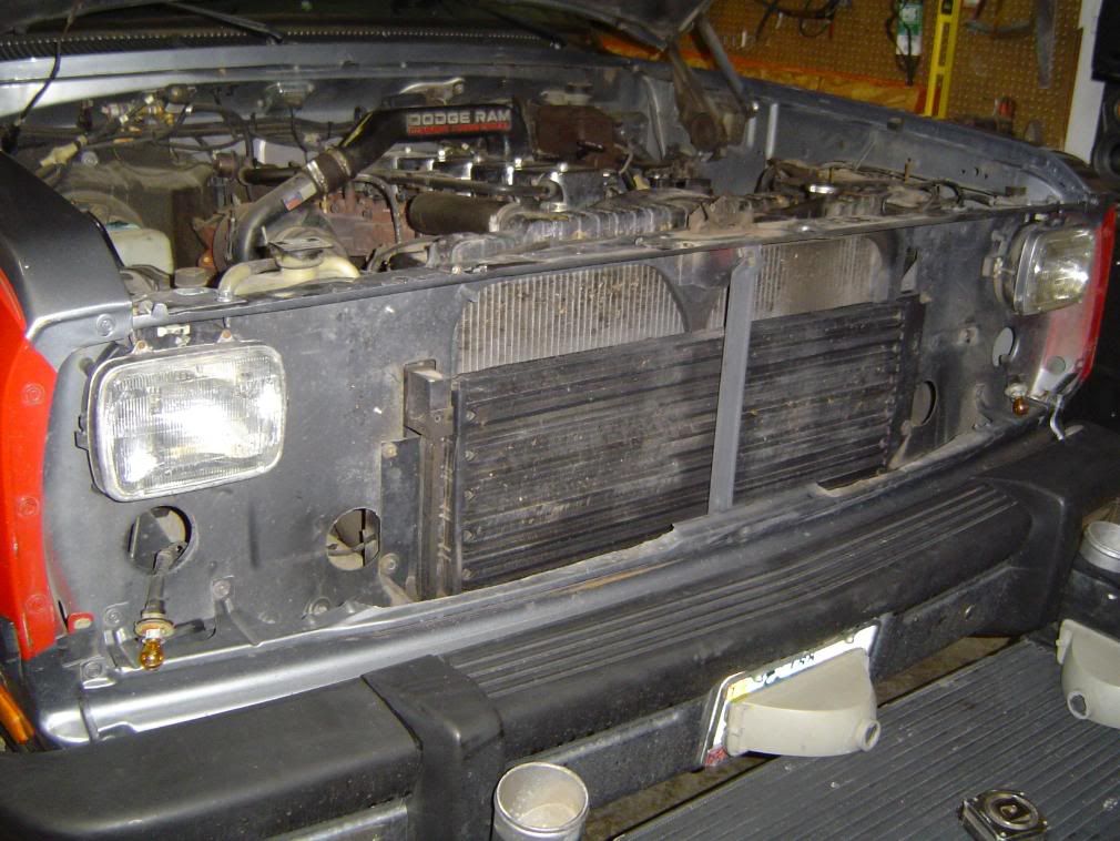

2nd gen intercoolers are not wide enough. Powerstroke works much better!

I don't now if the radiator support is different between the 89-90 but my 91 non intercooler support works just fine........snugs right up against the reinforcements. :thumright:
I would be nice to now if the radiator support is the same as the intercooled 91, or if it is the same as the 89-90........Or if it is it's own breed................
If any one has a pic of a 89-90 radiator support, with the grill remove...........I WOULD REALY LIKE TO COMPARE! ;)
This is what my radiator support looks like with the two holes in it for the banks set up!
I was showed how to make the pic come out instead of a link........So i though i would change this one! ;)

What?!?!?! How do you figure that?
2nd gen intercoolers are wider than a 1st gen intercooler, quite a bit in fact.
The powerstroke intercooler is about the same width as the 1st gen one only its a little taller and maybe a hair thicker.
