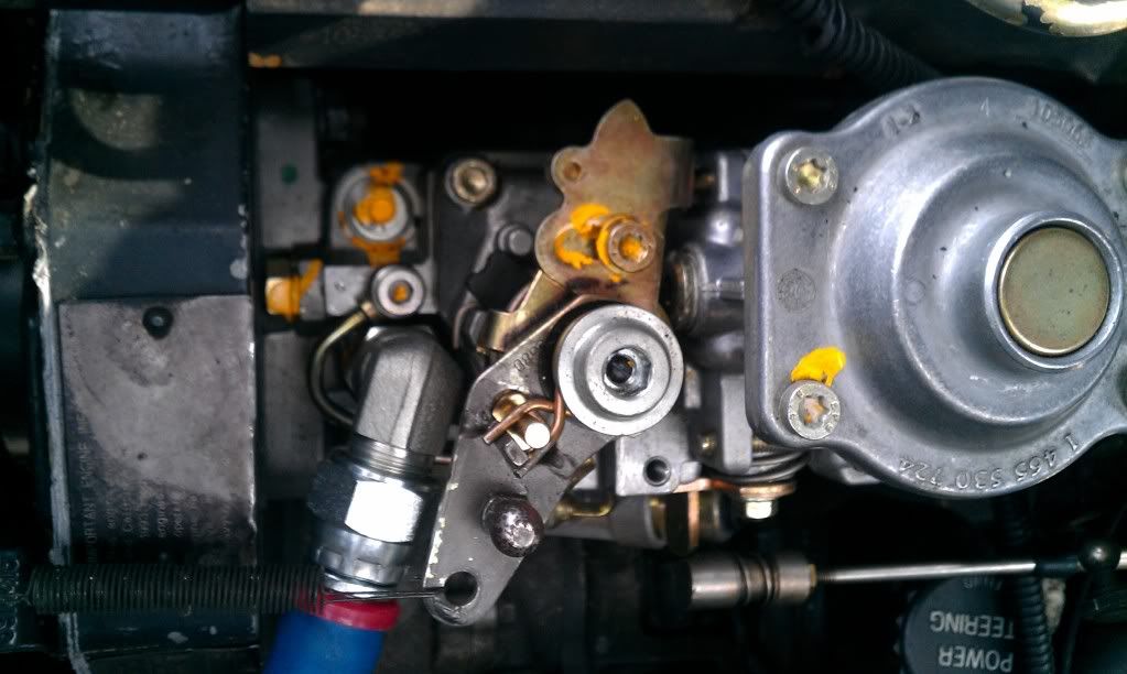

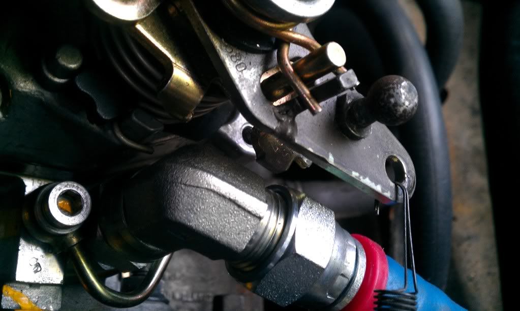

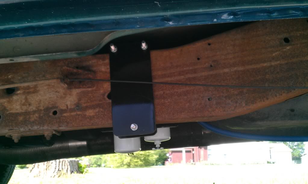

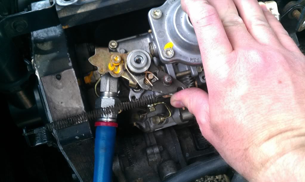

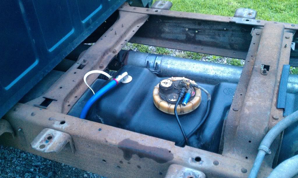

Dazed, I've been trying to get everything I want done to it and I'm not there yet, but I am closer. I'm going to have the cab painted sometime in the near future, and do the aluminum flatbed, etc. Here are some pics and a video.
Hellman sump and a stainless ball valve.
Airdog 150 setup for a p pumper. Bracket cutdown some and rounded so it doesn't cut my gut when I need to slide under the truck.
Return line in the top of the tank.
1/2" line to the pump.
I'm still trying to figure out the haze. When the old pump was on it, it had very very little haze. I'm not sure if the haze is because of the new pumps attitude and bigger delivery valves, or if I have another issue. I took the injectors out and they checked fine. They were within 2 BAR of each other. Checked compression and everything there seems fine. Maybe I just need more timing. :? There is new onroad fuel in the tank (about 10 gallons) but I did dump a whole gallon of 2 stroke oil in there too, so it may clear up some when that's gone. :lol:
