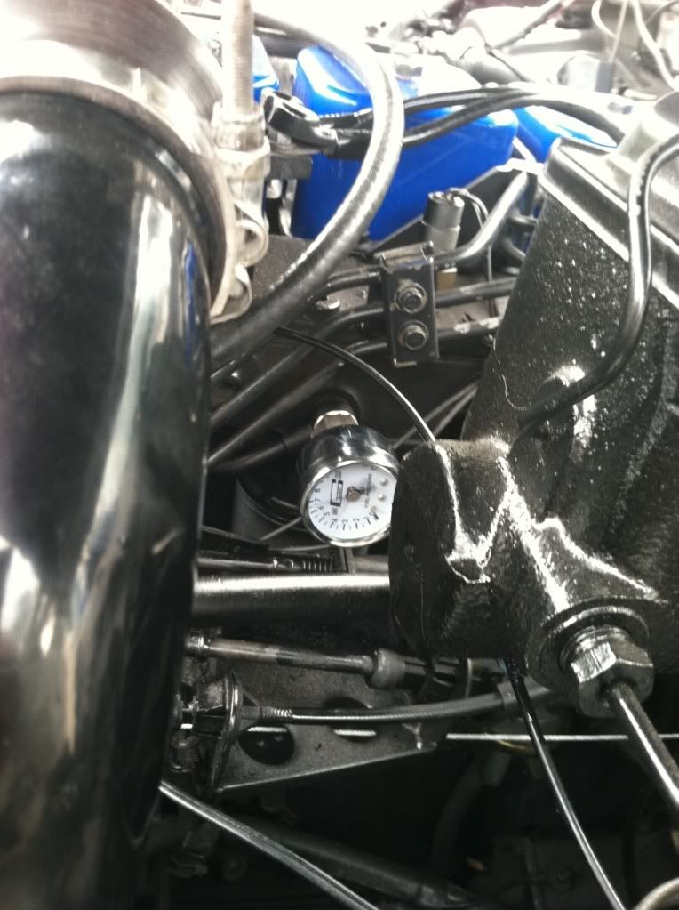

i had to send my isspro back because they sent black face and i ordered white so i stuck this mechanical one on for now. does this look right? it fluctuates ALOT!!!!! bounces 4-7 at idle? why? watch video and see
http://s1130.photobucket.com/albums/m53 ... G_0423.mp4

Postby BILTIT » Thu Oct 13, 2011 1:19 pm
Your reading with a stock mechanical pump will bounce wildy, a pressure snubber is needed to stop the fluctuations.

Postby BILTIT » Thu Oct 13, 2011 4:22 pm
Most just use a small valve which they can run just open enough to read the pressure but not enough to get the fluctuations.
Or you can try this:
http://www.genosgarage.com/prodinfo.asp ... LT-SNUBBER

the only reason u need the isolator/ snubber is to keep the guage alive, not to smooth out the fuel pressure going to the IP. the electric will be a pretty constant pressure
