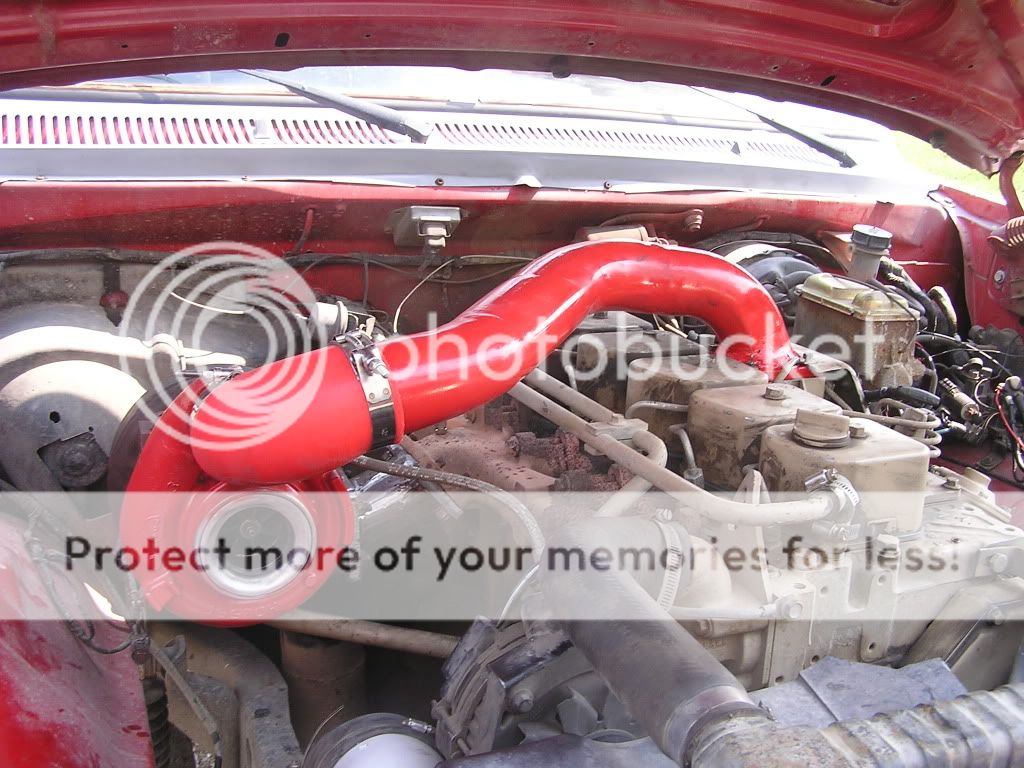

Postby Tacoclaw » Tue Jan 17, 2012 7:44 am
If you can't weld, or your welding skills totally suck, you can make something similar out of silicone connectors. For my setup I needed a 90* and 2 45*s, but if you're keeping the grids you'd need to swap the last 45* for a 90*.
These first pics had normal rubber connectors, which just popped, but I got some silicone ones from siliconeintakes.com that have worked out fine at 50psi.
viewtopic.php?f=4&t=5512&start=0

Postby fatstack » Thu Jan 19, 2012 2:46 am
Looks like they've got all the parts i need. That site could b addicting though lol
