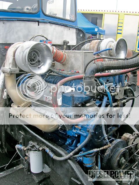

Okay then lets use our brains boys and girls! If the super is choking out the turbo is the super is used as your atmosphere, why not switch them around having a turbo as your atmosphere and the super as your compressing small one?
http://blogs.dieselpowermag.com/6434264 ... rcharging/
Ta-da! And detroit did the same thing, here's a video of a 8V92
http://www.youtube.com/watch?v=wGoM1bBN ... r_embedded
Here's a picture!
Though the blower was used for scavenging purposes and the turbo was the only real 'charger' the engines did make big power even by todays standards.
Plus with advances in technology and being able to help with losing some of the parasitic loss and Turbo to super charger compound system could work pretty well. Or do a actual twin (3 cylinders running one turbo) then those twins feeding the super. To me it seems most logical way so you have some boost at idle and boost to carry you up to when the turbo would kick in.

Superchargers can't have more then thier designed limit blown threw them. They cant handle the preasure and start flexing the fins then pop. Basically you are useing the super to spool a large charger then letting tge turbo do most of the work.
Re: There's a supercharger kit for our trucks?
Postby ellis93 » Mon May 07, 2012 8:54 am
The root style chargers are different on Detroits. The old motor I'm familiar with is the 8v71, it had to have the charger to force feed air to the lower part of the cylinder and push the exhaust out at the same time, not just to scaveng air. Far as I've heard they've had turbos on them as well.

I dont see how blow threw has anything to do with it. My understanding was so that the you had a turbo making pressurized air then the second one pressurized it more so you have more PSI. THe idea of a atmosphere turbo being double the size is so that the amount of air that is being pressurized is enough to not starve the small turbo. Its kind of a two stage process best way I can think of explaining it is you have a small trash compactor and a big trash compactor. You cant fit your initial trash in the small compactor but you can fit it in the large one, but the large one doesnt compact it enough. So what you do is compact it with the large compactor, then you put it in the small one and compact it more. So in the end all that trash that filled your mother in laws house now fits in the trunk of a prius.
EDIT: Ellis I know that on the Detroits the blower was used to push out the old exhaust gasses and make sure that air went in one way, but it still theoretically made some form of boost may just have been a few PSI but it still made it.
