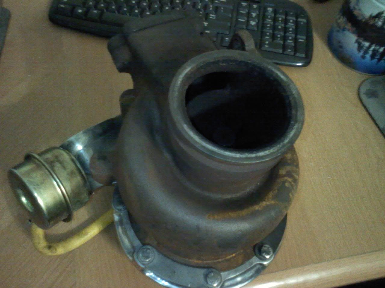

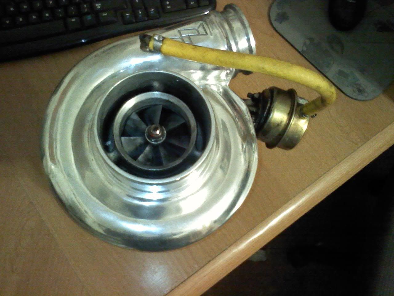

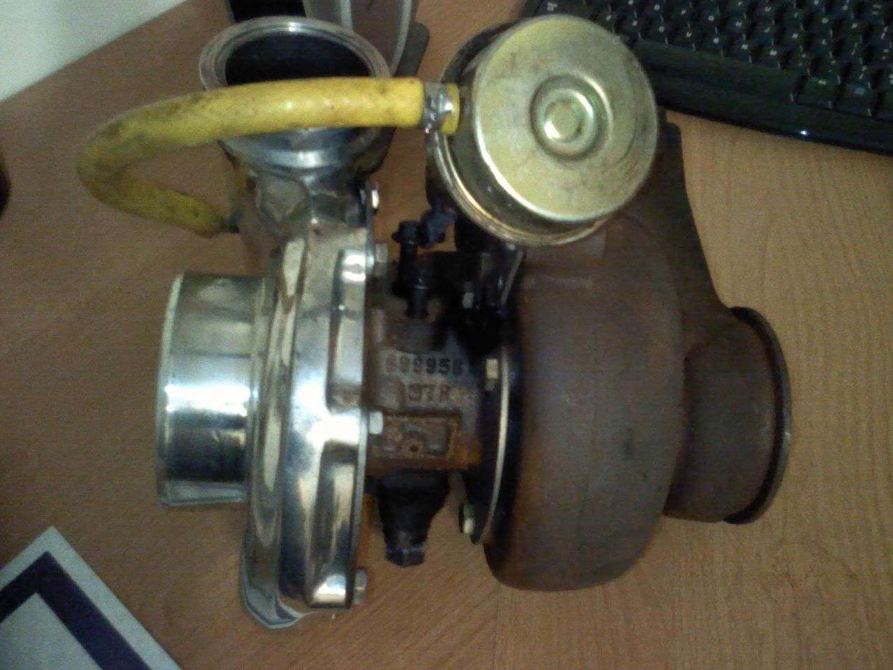

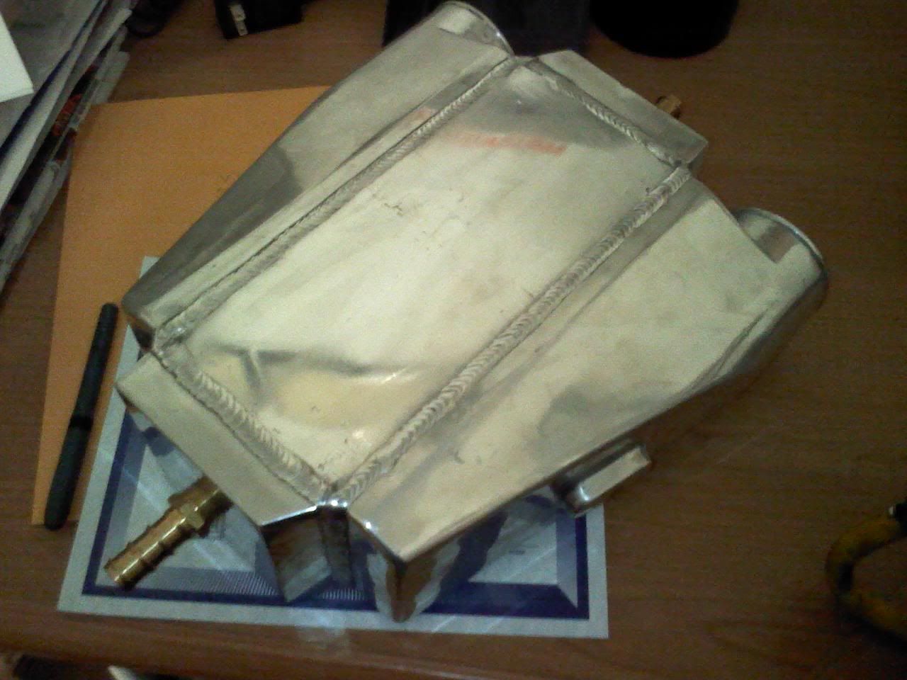

What adaptor do I need for the compressor outlet? I have a custom cross over pipe made out of exhaust tubing so I just need something to use a vband clamp that I can put a sylicone boot on. The Air-to-Water is going over were the battery is now (as soon as I find a spot for it). What adaptors do I need and were can I get them? Here is my cirrent setup. I would like to keep with something like this for the short term till I get the a2w inplace.

It's hard to tell from the pic, how big is the cooler? 3" inlet and outlet? It looks restrictive, and the air having to go 180* in there won't help either.

It depends on what the turbo is supposed to fit as to what v band piece you will need. the one i used on my non ic truck with a s300 was from a 2001 frieghtliner medium duty bus chassis and it worked great. as for the hoses and clams along with alot of other cool stff got to www.racepartsoulutions.com. hope this helps
Yeah its 3" I dont see it being anymore restrictive then the factory Air-to0Water that KTA made over 600HP with. It's rated for over 1000CFM so we will see. A few others are running them and have been very happy. I refuse to cut up my grill to mount an intercooler.

I saw a pic of a rig that had that cooler and he moved the washer fluid bottle and mounted it there. He came out of the turbo and a straight shot into the cooler then built a crossover from the cooler to the intake. Looked like the easyiest way to mount.

Yeah richie thats my other option. I just need to find a flange for the compressor outlet on the turbo.

I played hell getting a elbow for my s300. I needed the 3 inch outlet to match my powerstroke cooler. I ended up getting a 70 ish degree elbow and made it work. I really wanted a 90 degree 3 inch but it works fine. Also took a week to get the oil supply adapter for the s300. My baby H1C had the oil feed directly screwed into it. The s300 takes the adapter like the later trucks have. The first one they sent was mispicked and did not work. Its frustrating some times. I ordered gauges and they sent me all black face gauges like I wanted but sent me a white face fuel pressure gauge. Had to send for the correct color. :evil: I hooked up my tach and that was frigged up so I sent that in and got another one. :evil: :evil: Sometimes these trucks just wanna fight back. :roll:

just buy a v band flang and weld a 90 or 45 degree pipe to it and ya got an instant elbow

3" OD 90* turbo compressor elbow school bus, Freightliner, Ford (industrial app) Cummins part number 3918685.

Damn it's hard to read these threads when they're stretched across the screen. I've got the oil inlet adaptors, and elbows in stock. I believe at least a couple of them are 3", with varying angles. I'll look if you need one.

PM me your mailing address again, I'll send you a couple of them to try out. I have one from a 2nd gen 12 valve. It's got a longer than 90* radius and is 3". Another that is 3" and short radius 90*. The other one I have is 3.5" and greater than a 90* radius. You probly wouldn't want it. If one will work, want to trade for those stock injectors I owe you? 8) :D
