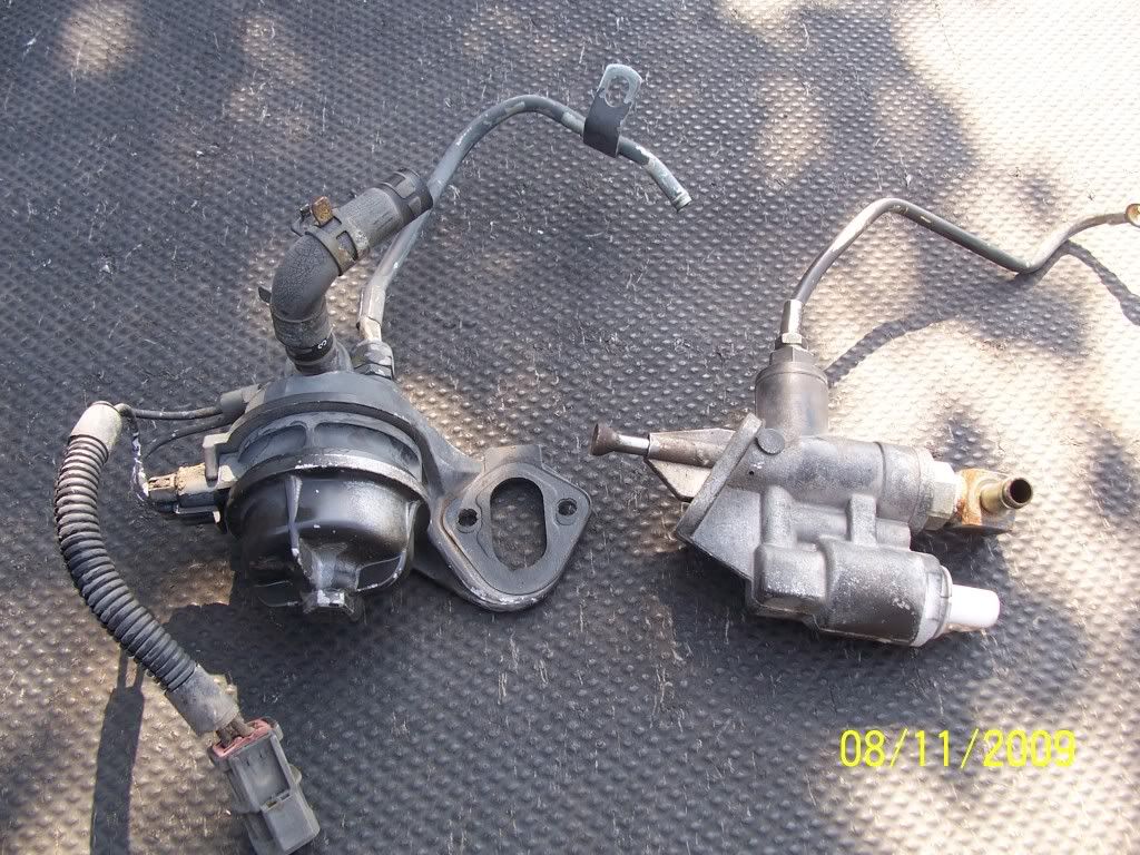

Postby BC847 » Mon Aug 10, 2009 7:01 pm
That pump shown was a good one. :roll:

Postby BC847 » Tue Aug 11, 2009 5:47 pm
I'm glad some of the things I've done are helpful. :D
But seriously, that pump shown was a good one. I think it's out on the porch in pieces (not ruint, just apart). :?
