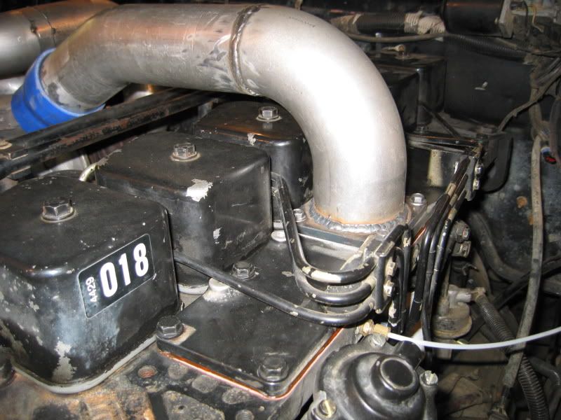

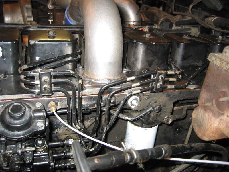

Postby Mark Nixon » Thu Dec 03, 2009 11:45 am
Pics of the set-ups.
Non-Intercooled:
Intercooled:
Non-I/Ced, I/Ced "Hybrid":
Modified bracket support installed:
Unmodified I/Ced throttle bracket support:
In the 4th picture, the one depicting the modified bracket support, you can just see the 2 line supports in place.
These are not the original non-I/Ced pieces, but the substitutes already installed.
Also, if you look at pic 3, you'll see the 3rd hole in the injection pump support bracket, this hole is the one used for the rear vacuum/p.s. pump support.

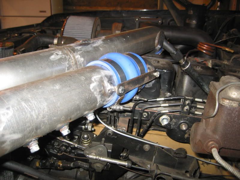

Postby CaptainChrysler » Thu Dec 03, 2009 4:49 pm
I just modified the bracket to work. Basically cut it off right above where the actual throttle bracket bolts on. Then add a tab to tie it to one of the bolts used with the IC style. I used a stud in the head to make it easier to take on and off. I can't say it has a lot of miles on it but plenty of throttlin' and it has stayed put. :lol:
Only had to modify the rear line holder to work with the top plate flipped. It used to have 2 isolators, but now has 1. You can see the 2 shiny spots where they used to be.

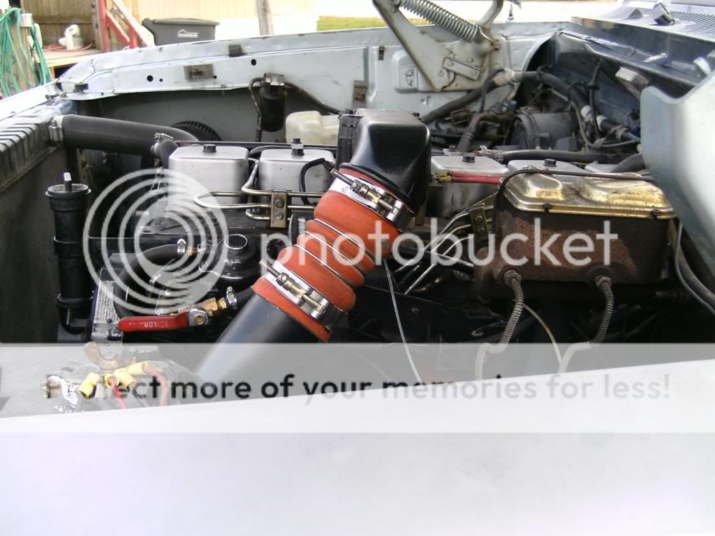

Postby dpuckett » Tue Dec 15, 2009 6:40 pm
Considering how the 2ndGen intake horn bends around on its own, it doesnt seem like it would interfere with the brake master cylinder like one using a stock IC 1stGen set up would.
I put a 12V 2ndGen intake horn on Rumblefish's pickup, and hacked off the brace on the front of the intake horn- seemed to hold fine at the time. Cant speak for the last year or so......
