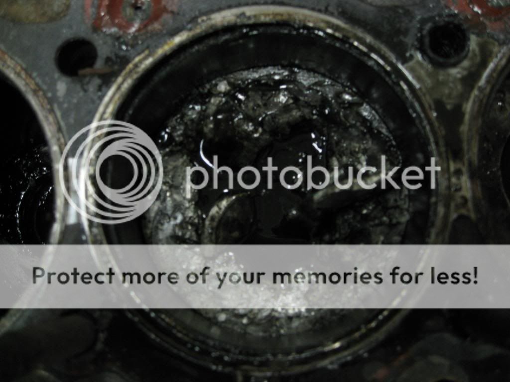

I'm melting pistons at 120.

Postby soggy » Tue Jul 20, 2010 9:56 pm
mhuppertz wrote:
fatty wrote:
soggy wrote:I cut two turns out and ran it up to 124 mph and it was still pulling, I had to let out because of egts. With 265/75/16 tires, 3.55 gear ratio and .069 OD ratio that puts me at 3230 rpms without accounting for TC slippage.
124 mph in a rattly old first gen?! :shock: :shock: You must be insane!!
Yeah, me too, might have contributed to this. :D

Postby fatty » Tue Jul 20, 2010 10:04 pm
That looks like you floated the valves to me.
Posts: 802
Re: 3,200 RPM spring cut
Postby soggy » Tue Jul 20, 2010 10:16 pm
fatty wrote:That looks like you floated the valves to me.
How could you possibly think that by looking at this picture?

Postby fatty » Tue Jul 20, 2010 10:35 pm
Well the piece of valve embedded in the top of the piston and the overall chewed up appearance are the clues that draw me to this conclusion.
Posts: 802
Postby soggy » Wed Jul 21, 2010 1:08 pm
Your argument is ridiculous, it makes no sense.

Postby oldestof11 » Wed Jul 21, 2010 1:10 pm
I can see what fatty is saying, thought I disagree. Look at the 3 O'Clock position. Looks kinda like a sun-dial.
Postby fatty » Wed Jul 21, 2010 1:35 pm
oldestof11 wrote:I can see what fatty is saying, thought I disagree. Look at the 3 O'Clock position. Looks kinda like a sun-dial.
I'm almost positive that's a piece of a valve. I don't see how melting would cause the valves to break off and bounce around on top of the piston.

Postby diesel freak01 » Thu Jul 22, 2010 4:45 am
broke a valve spring from high rpms possibly? or timing jumped and the piston hit the valve?

Postby BC.livewire » Thu Jul 22, 2010 5:10 am
sounds like you ware making a hi-speed run and even thow your REV spring was deefueling becouse yu ware runing past 3,200 rpm you keep going ontill one of the valve springs let go
you do know that they cummins need better valve springs for over 4,000rpm ?
even thow your pump was deefueling you still had enef fuel to get close to the 4,000 rpm limit of the stock vlave springs ---- and than your wheels hit a little bump in the road cozing them to bounce thus over REVing the motor
this is my guess --- and yes I have seen this happen in other cars and turcks ---- it all comes down to the driver pushing his motor past the limets
