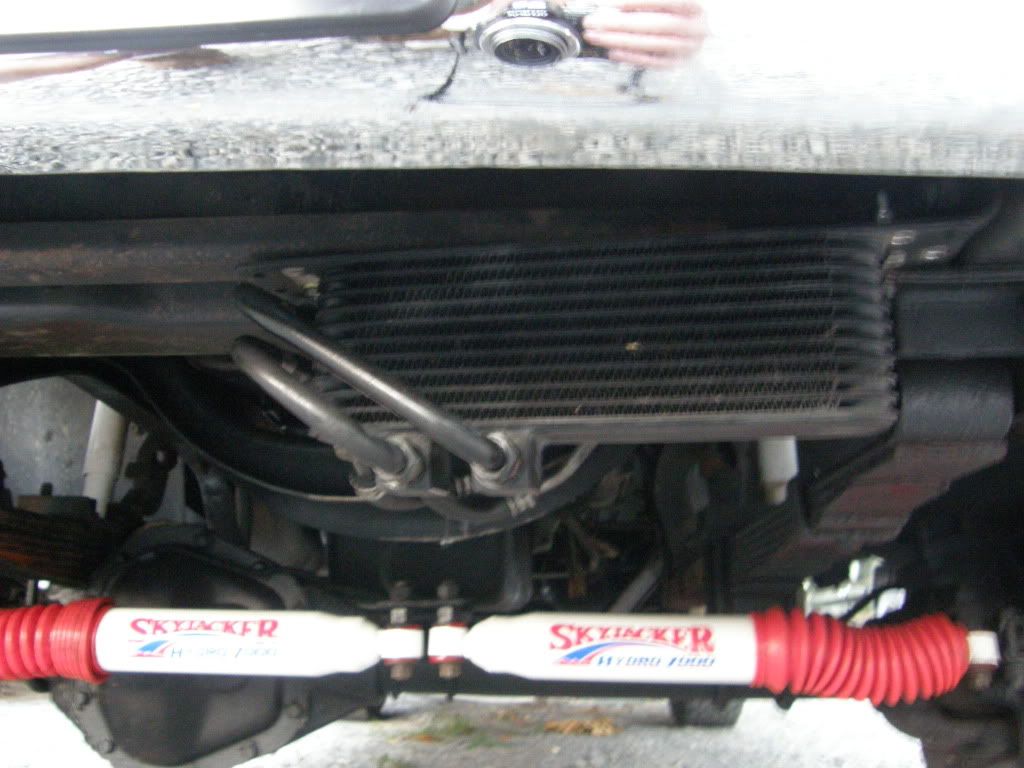

Well finally got in the P/S intercooler and Tims cooler tubes and i lost 125* at 70mph and 100* WOT
now i can only hit 1500*, mounted the tranny cooler under the bumper. very happy so far.

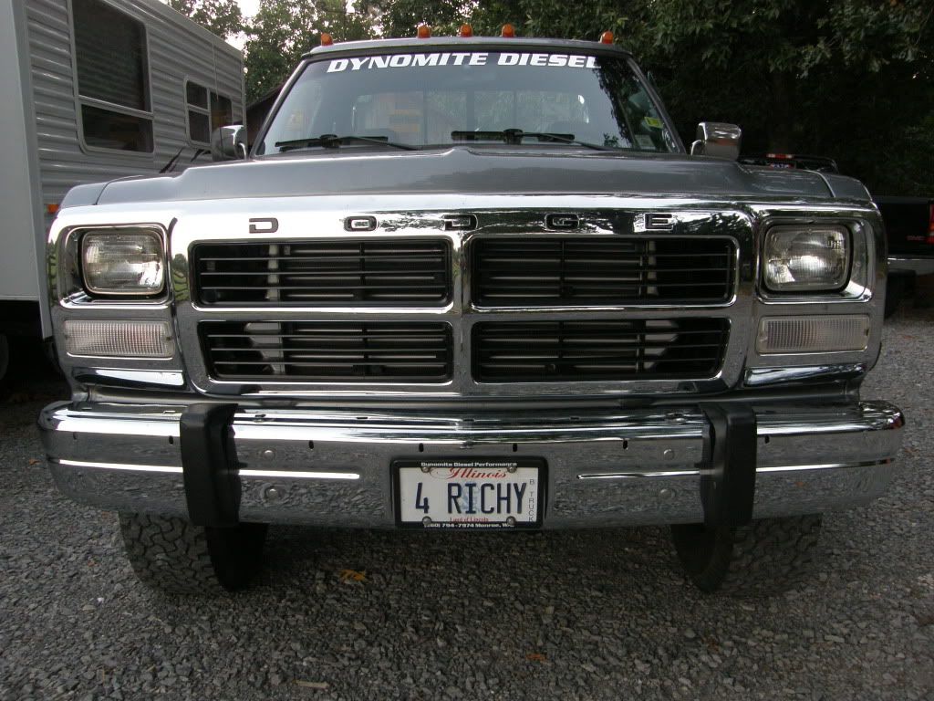

Looks good Dar! I like the polished valve cover cover. 8)
Don't let Richie see that plate though, he'll think the truck is his! :lol:

PToombs wrote:Don't let Richie see that plate though, he'll think the truck is his! :lol:
I will be down next week to pic it up. THANKS!! :D
