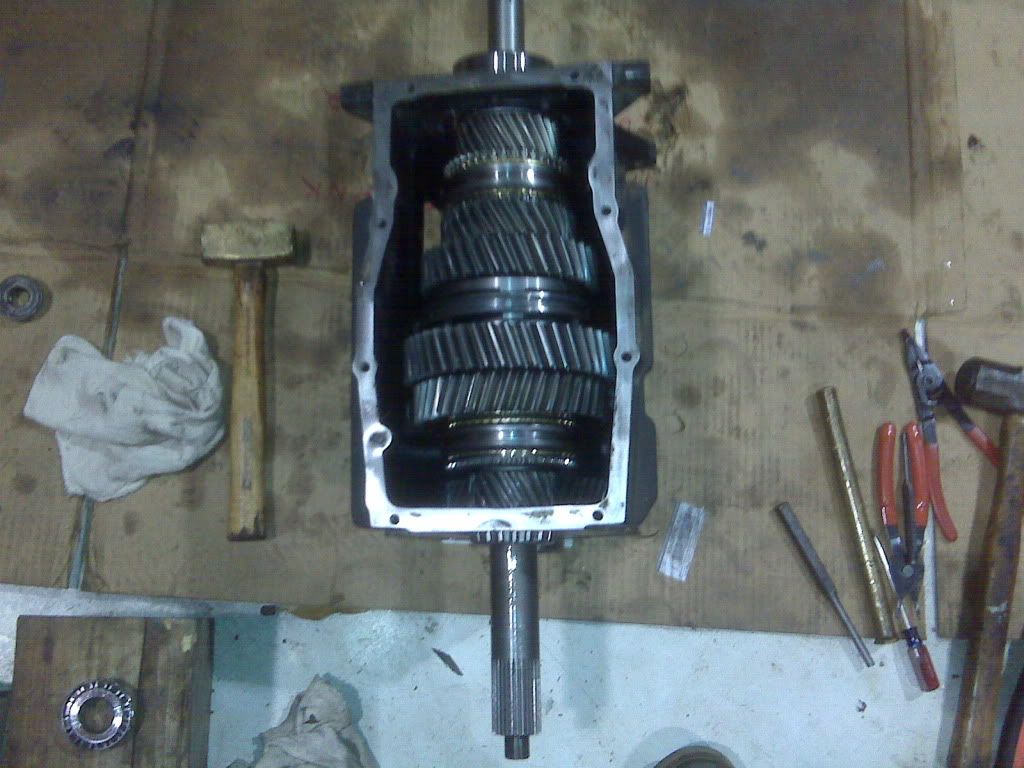

Now I tear in,starting with the shift covers 8 bolts
With the trans in neutral the cover should lift up
Next the input retainer and bolts
Now the yoke,tail housing and its bolts. Don't forget to pull the speedometer gear and housing.
Under there should be shims for the counter shaft and main/output shaft. Also,if your working on a 2wd, there is two spacers and a speedometer drive gear.

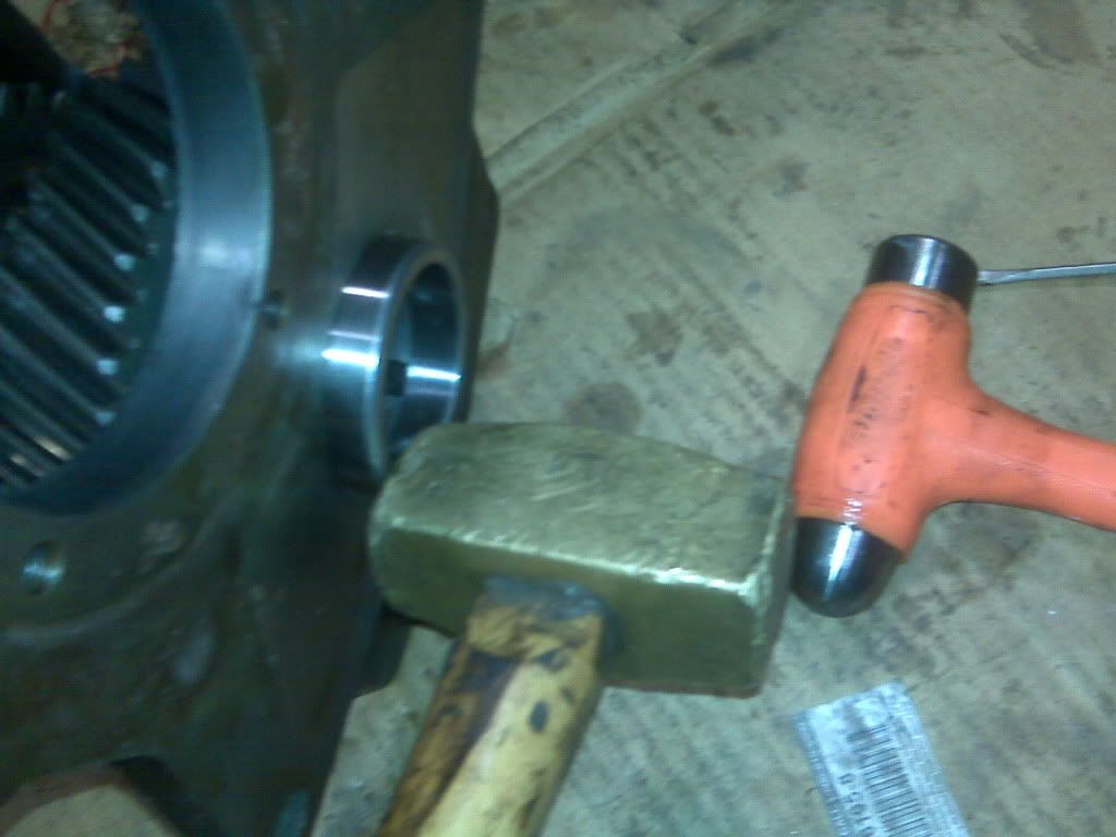

After all that is out of my way I pop the races out of the case with my trusty craftsman screw driver. I take the blade and wedge it between the outer race and the bearing cage. Working all the way around,walking it out
Input
Output/main shaft and rear counter
After they're out of the way,you can wiggle the input forward and pull the mainshaft backwards to get some space between the two. You'll need this gap to get the mainshaft to come up and out of the case
If you look at the raised end of the mainshaft there is a slider there. DON'T let that move ANY! If it moves there are shift dogs/keys that have balls and springs in them. If the slider moves the balls and springs will fly like bullets,this is one of the times when the glasses are needed,remember don't be a dumb*ss LOL
Now press down on the rear of the shaft and lift up the front and it should come right out
After its out of the way you can pull out the input shaft

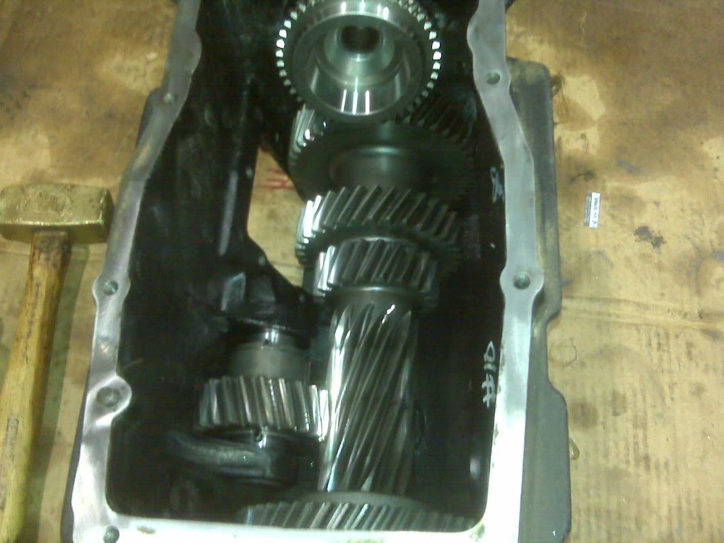

Now we have a good look at the counter gear and reverse idler.

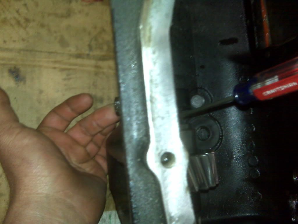

I now want to remove the reverse idler and its parts. There's a bolt on the outside of the case,it comes out first so I can angle the shaft to drive the roll pins out easier.
Now both pins

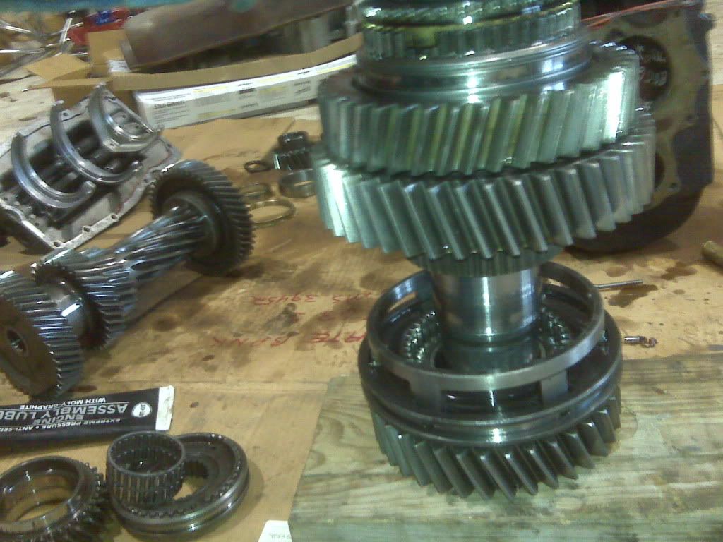

Here is how I get it off and how the 6x6 comes into play
Pick the shaft up and let it fall,nose down,agains the block. This is what should come off after a few good hard drops

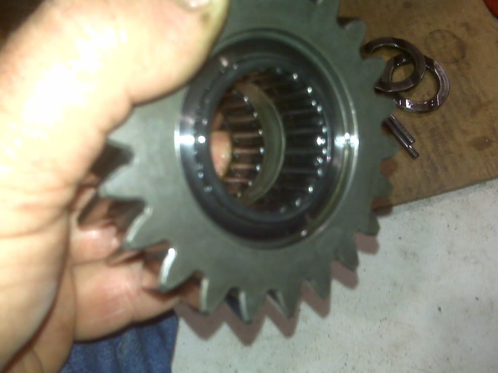

Ok now I lube and install the 1st gear needle bearings
Before you slide the 1st gear on you'll need to remove the old syncro,I pry it off EVENLY and put on the new. This gear there are roll pins that have they're holes drilled all the way thru. Bump them out and back in thru the new syncro first.
Make double sure that the roll pins are flush with the inside of the syncro,otherwise you'll not have full engagement of the collector ring :x
Slide the gear on and find its retainer and snap ring. It may not matter but I always make sure to keep the old surfaces against the same places. This pic shows where the needles and bearings rode against the retainer.

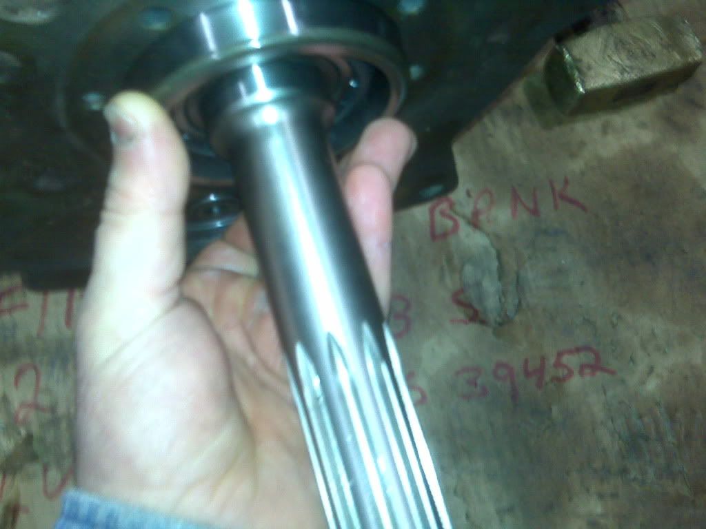

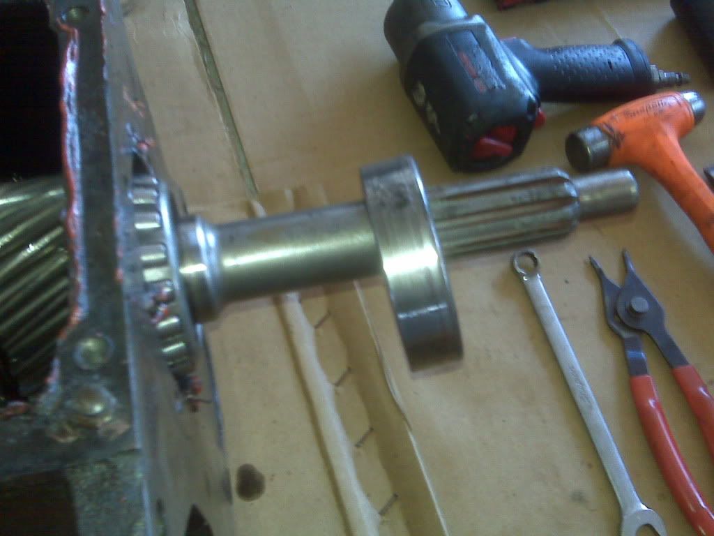

Now for the rear bearing,usually I use a press to mash them on but since most folks don't have one in their back pocket I did this to show you can do it without.
I drove in on using my brass drift and even,medium forced blows,around the inner bearing race. I was careful of the bearing cage, to avoid any contact with it, it can withstand some but its better to stay away.

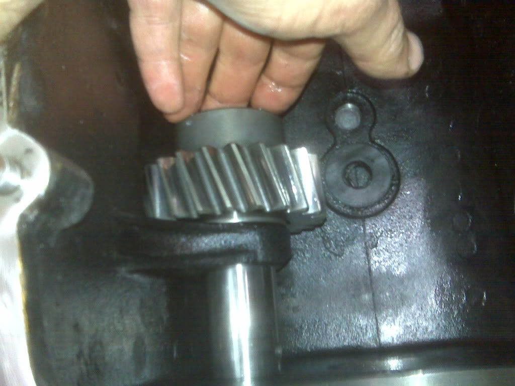

Now that the mainshaft is together I turn toward the case and reverse idler.
Take the idler and slide the needle bearings inside along w/ their spacer, should be bearing-spacer-bearing
Now I take it and one of the thrust washers ,there are oil grooves and a square slot on them,square slot points away from the gear,and put it in the case with the idler shaft started in its bore. Notice the hub on the gear goes to the front of trans
As I push on the shaft,I make sure one of my fingers are holding the bearings in. Once the shaft is flush with the outside of the gear,I slide the other thrust washer down next to the gear and push the shaft the rest of the way in. The rear roll pin will need to be driven in before you go any farther,once the front roll pin is in you can't get at it because the gear sticks out over the hole. When its all in I take a small screw driver and insert it in the front roll pin hole to allow me to turn the shaft so I can start its bolt
Once the bolt is started,drive in the last roll pin and it should look like this.
That pic was taken directly over the gear,notice the rear pin can't be seen

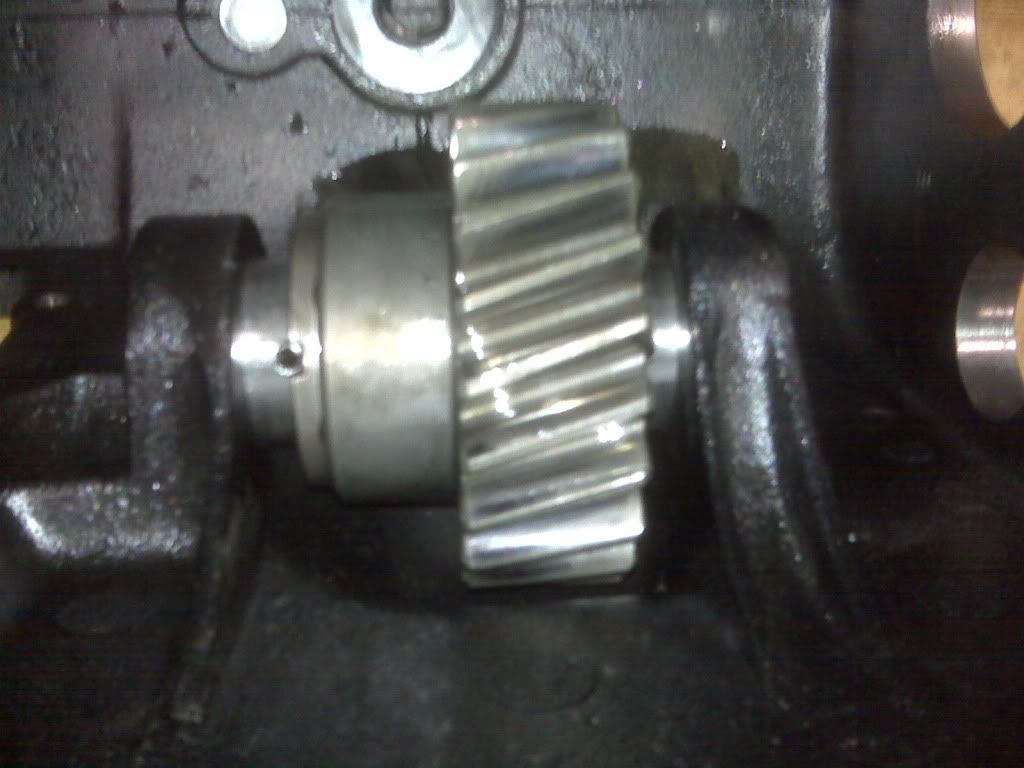

nows the time to drop in the counter/cluster gear.

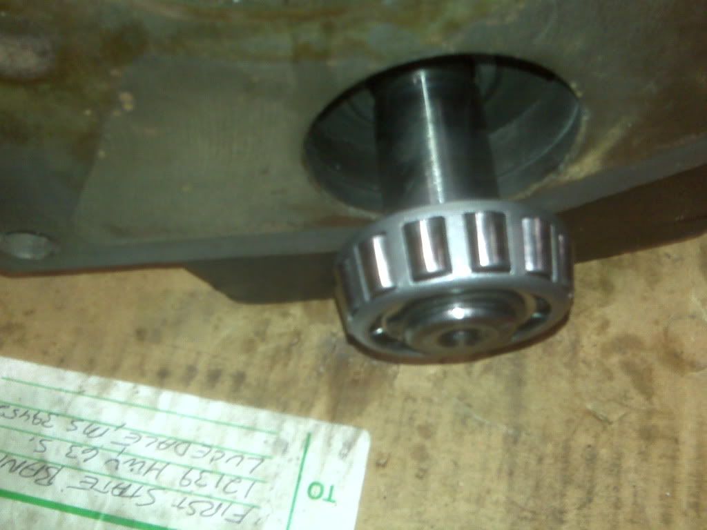

Now its shaft with a new bearing drove on its front.
Don't worry it won't go but one way. Make sure the bearing points outward.

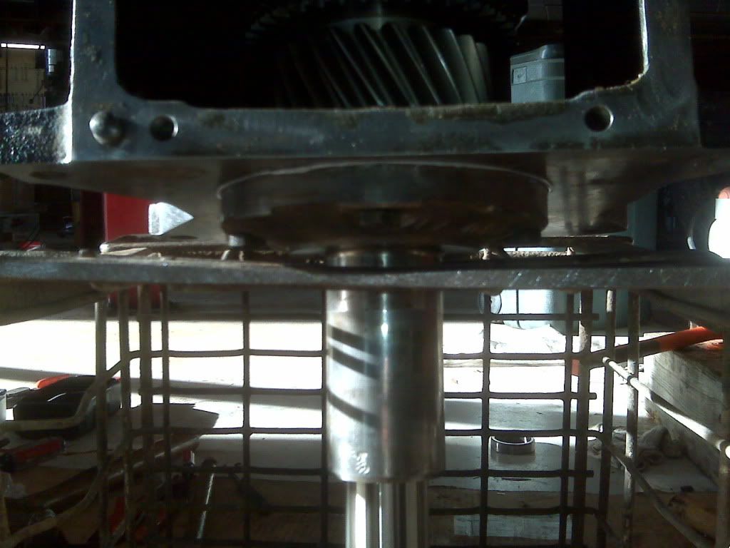

I turn the case on end an install the other bearing. I also have a small piece of brass backing the other side of the shaft,this keeps the force from driving the other bearing on off of the race snap ring.

Postby Mark Nixon » Fri Feb 17, 2012 10:22 am
Just a note.
A piece of thinwall conduit, or even a section of mild steel plumbing pipe, that fits just inside the outer diameter of the inner race will allow a person to hammer the bearing onto shafts evenly.
This is given that a person doesn't have a taller press to push them on with instead.
