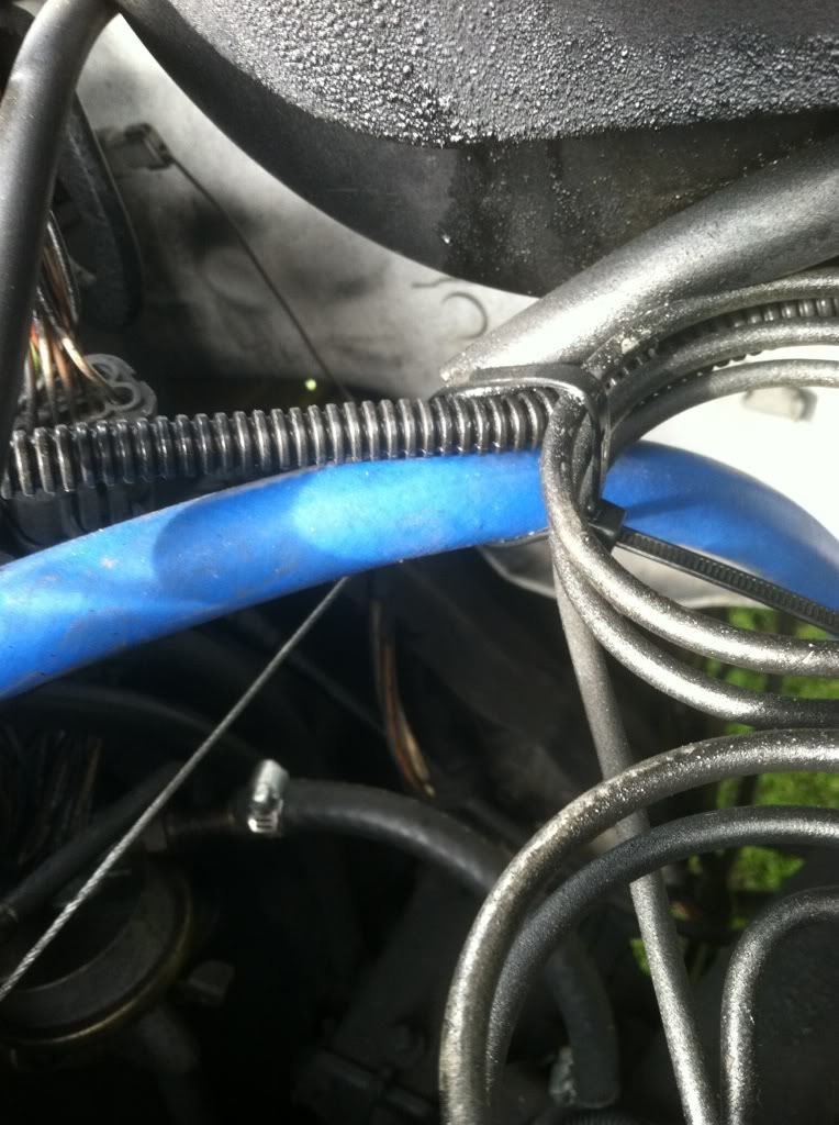

I started installing my raptor fuel pump and was installing my male fuel fitting that screws into the inlet side of the stock fuel filter on the intake manifold. I found out that my throttle and cruise control bracket on the engine is in the way. Can anyone help me?

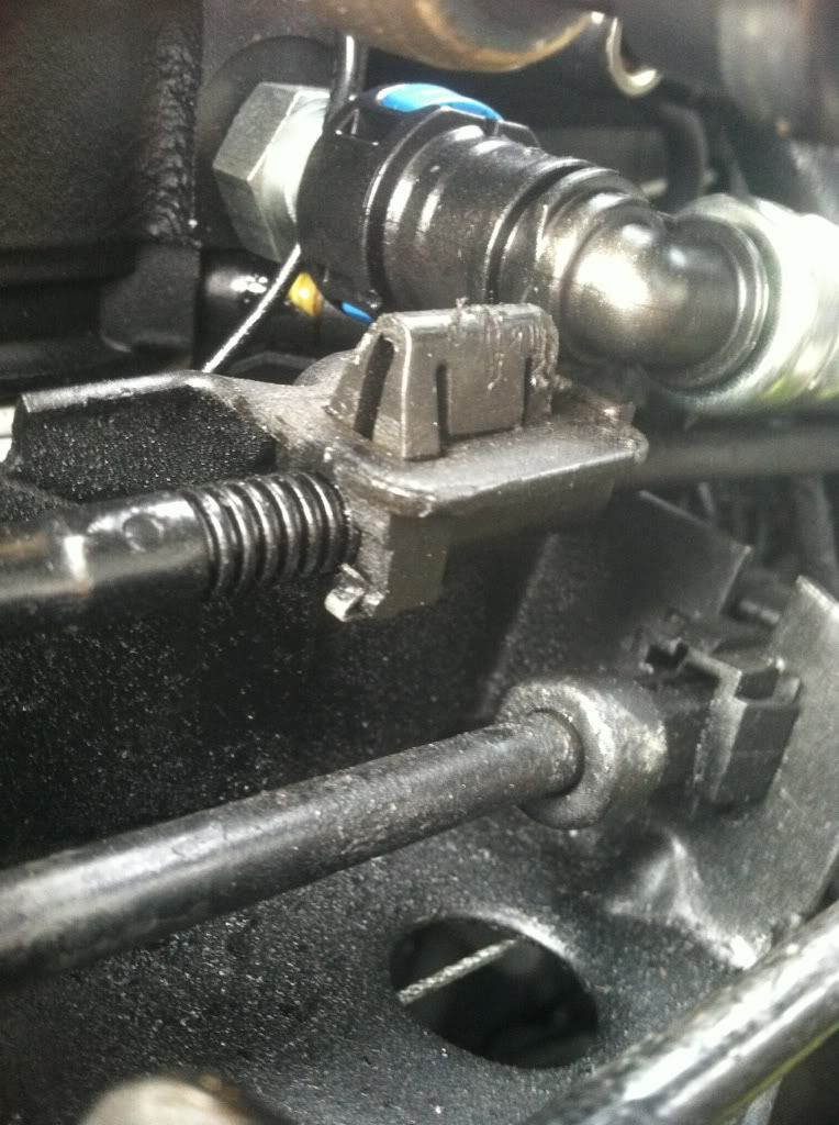

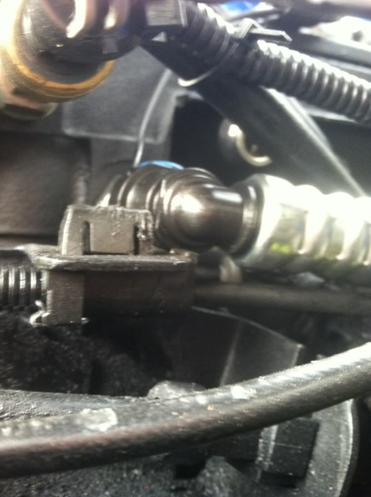

Here is another picture with the fuel elbow snapped on. The throttle bracket is barely hanging on because it binds up with the new fuel fitting and elbow

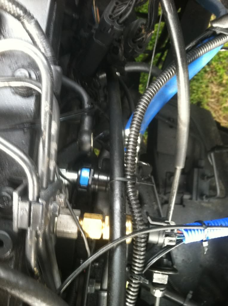

hey! had the same problem. FLIP IT UPSIDE DOWN AND MOUNT FROM THE BOTTOM. its hard to snap in but it will work! be sure you turn your pressure all the way down before you turn it over or you will risk blowing the ip seals. happend to me. came preset at over 30psi. the lowest it goes is like 8psi so you can turn it all the way down, start it, then go up from there. flip that bracket and a few wire ties to keep my fuel line off my manual shut off cable is the only alterations i made. may have pics in my photobucket and if not i will snap a few in the morning for you.

i will take pics of the hook ups and how i flipped the cable/bracket 2mar. simple.

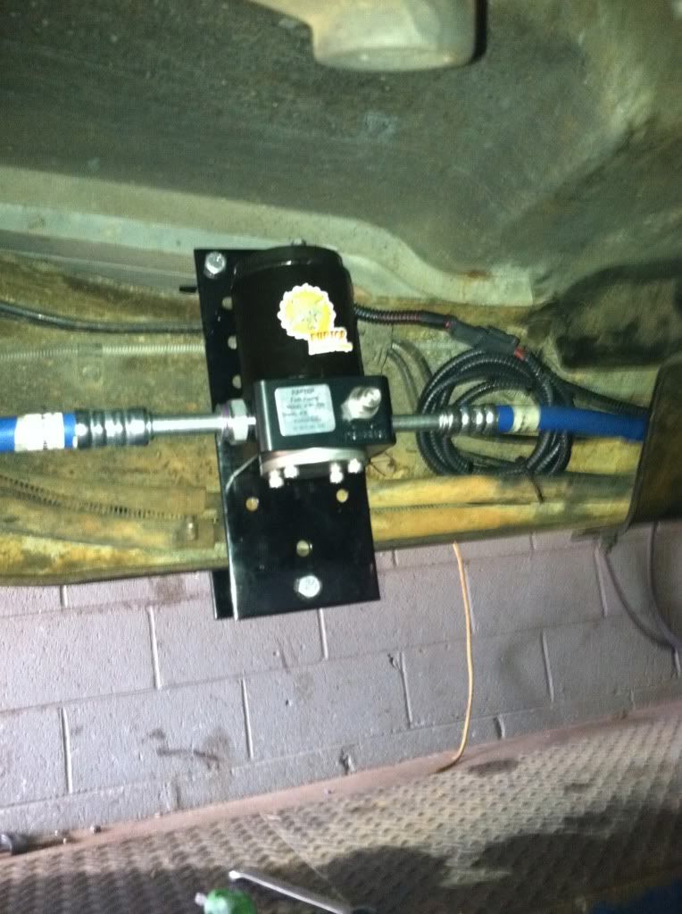

Postby 93DodgeCummins » Mon Dec 19, 2011 10:12 pm
I got it figured out. I set up a relay for the pump and flipped the cruise control cable upside down on the bracket. Pump sounds really healthy. I will make a video and post it when i get time

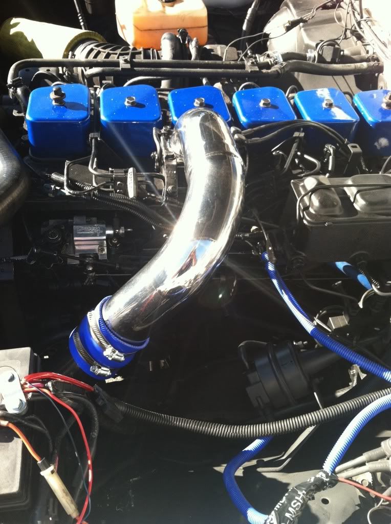

Postby Tsbourne09 » Tue Dec 20, 2011 2:39 pm
Lol n now i got u pics...
Wired it to ignition

Postby 93DodgeCummins » Tue Dec 20, 2011 4:52 pm
Wow you have a clean engine. Mine is kind of a mess..
