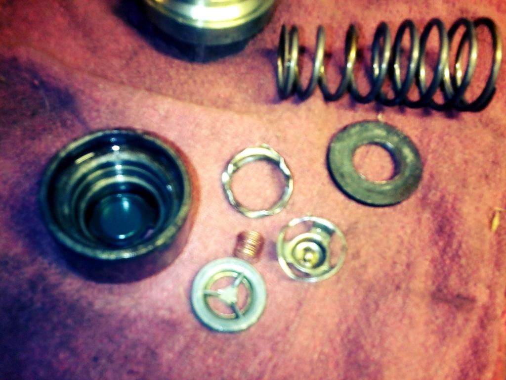

so i'm just getting around to rounding up parts to install a hvlp lift pump that i got used from a member on here. figured i'd open the pump up real quick before installing it just to make sure everything is good to go inside. and here is what i found:
i'm sure the seller had no idea it was like this since he had ran it with no issues before pulling it off in favor of something else. i've sent him a message to discuss options but i'm curious what everyone's opinion is on what can be done with pump. is it salvageable? what should i do?

anyone? appears the parts that got chewed up are the diaphragm/one way valve that lets fuel travel from the inlet side to the pressure side of the piston?

i wish that was the problem, the diaphragm is trashed, as in it came apart and the previous owner kept running it without knowing, then sold it to me....
