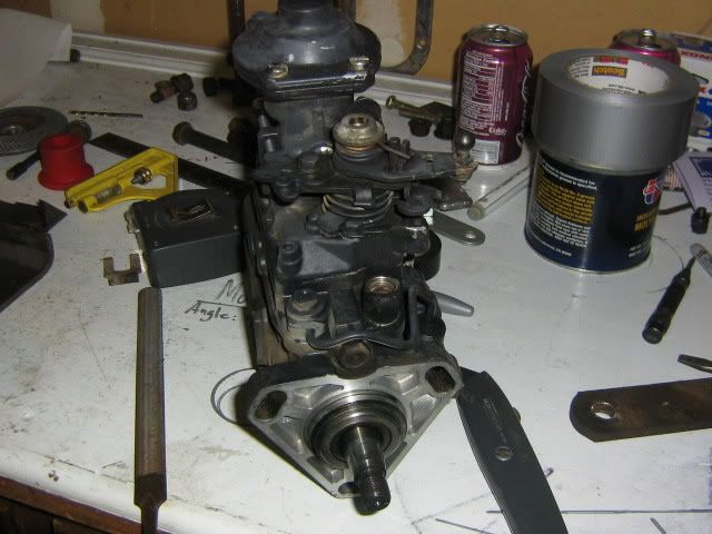

Postby aspoonhour » Wed Aug 13, 2008 6:23 pm
Not sure that this pic will help, but maybe it'll help you envision where the 3rd one is.
I've read that it takes "U" shaped wrench. I'm sure someone has a pic a some info about it.

Postby 1991cummins » Wed Aug 13, 2008 6:33 pm
wow ok awesome... that pic helped a bunch thanks... why is the pump so freakin hard to turn... and is there another bolt on the other end of the pump right next to the shut off sylonoid??? cause it looks like there is but it might not be necisary to loosen up...
