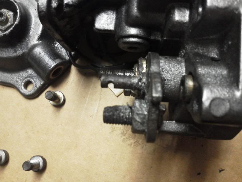

Postby nyford » Fri Sep 13, 2013 9:24 am
Throttle shaft is a little worn.....
Fummins project. 89 f350 w 95 front end, 4x4 dually crew cab, 89 6bt, pump tweeked, studded, marine 370's, intercooled, 4" turbo back, 12 cm housing, nv 4500. divorced 205, 4.11's, 265/70/19.5's

Postby PToombs » Fri Sep 13, 2013 3:55 pm
That's just the pin the centering spring sits on. Just weld or braze it back up. Is the centering spring bad? You should replace that if it's got a notch in it, welding won't cut it. Check the flat bar that sits next to the pin, it may be worn also. I welded up my bar and pin, then sanded them to smooth them out and not wear the new spring out right away.
Re: So I blew a head gasket, now what to do
Postby CumminsPower59 » Fri Sep 13, 2013 4:00 pm
I'm too lazy for welding it up, as mine was just as bad, along with the spring. I just dug up the Bosch part numbers and went to the pump shop I deal with and ordered new ones :mrgreen:
Postby PToombs » Fri Sep 13, 2013 4:11 pm
At $60 for a lever I wasn't going that route. ;)
Postby CumminsPower59 » Sat Sep 14, 2013 1:22 pm
I can't weld thin stuff to save my life, so knowing my luck I would have just burned it off and have to buy the lever anyways :roll:
