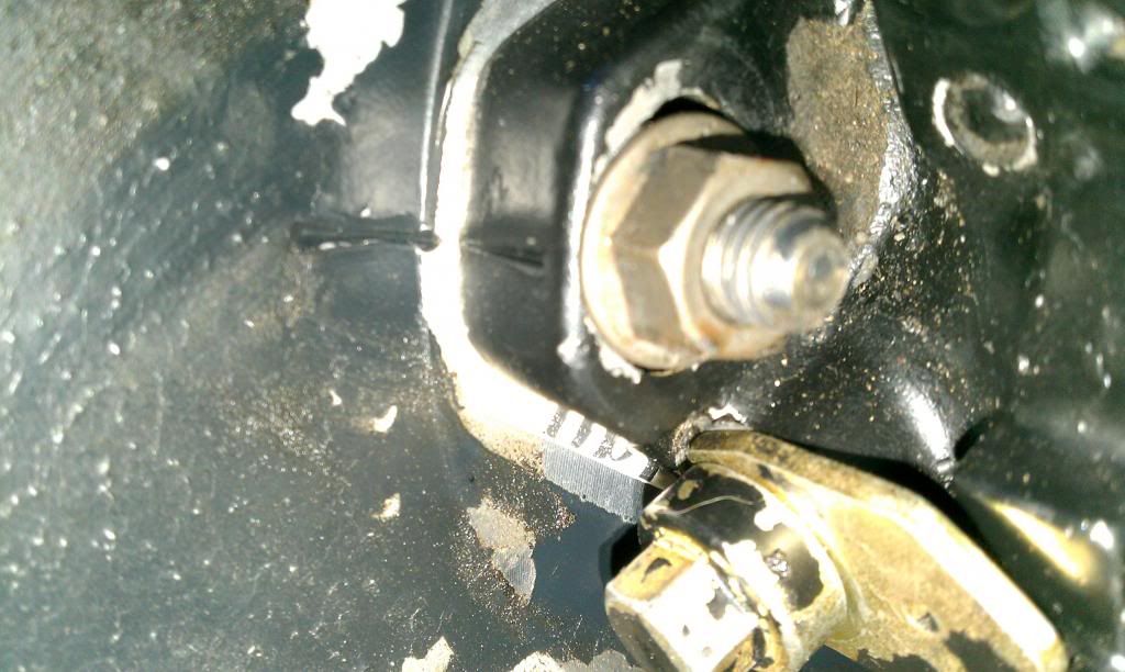

Postby 93DodgeCummins » Wed Feb 13, 2013 3:42 pm
I got it running but now its giving me more greif... http://www.youtube.com/watch?v=qDWeRS2R ... e=youtu.be Here is a video to show whats its doing. I was thinking maybe the timing isn't right but I lined up the pump marks

Postby PToombs » Wed Feb 13, 2013 5:54 pm
Easy to find out, just turn it one way or the other and see if it runs better. Towards the head advances it and away is retarded. Try moving it away 1st and see if it's better, and go from there.

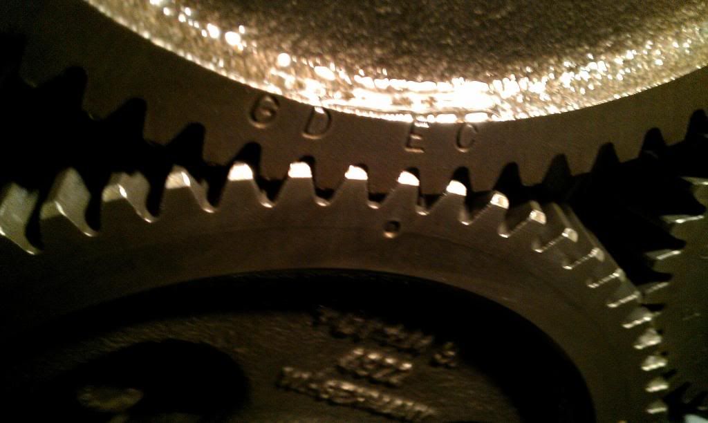

Postby 93DodgeCummins » Thu Feb 14, 2013 5:13 pm
I think it skipped a tooth because i think the dot on the cam gear is supposed to be in those letters? What you guys thinking?

Postby RCCUMMINS89 » Thu Feb 14, 2013 5:24 pm
You're good... IIRC
Re: Super sized injection pump LEAK!!!
Postby 93DodgeCummins » Thu Feb 14, 2013 5:26 pm
that must mean my pump is off time then :shock:
