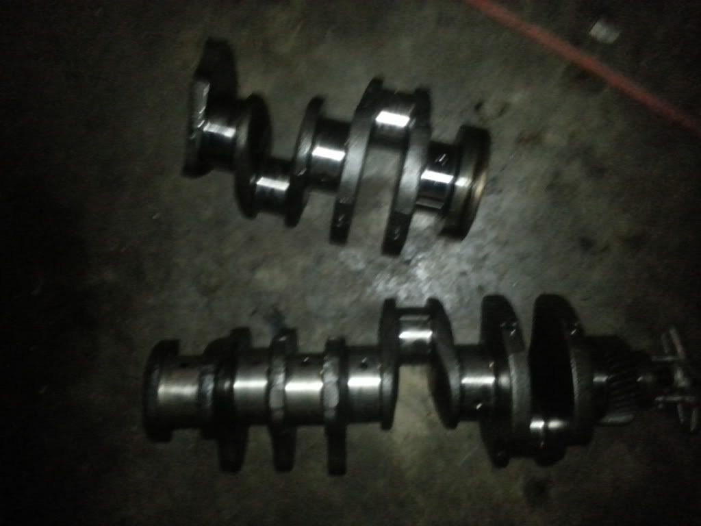

yeah I'll post some more pictures when I pull the crankshaft out let you guys know what's going on .I'm afraid to put this thing on my engine stand it's pretty heavy anybody know how much a block weighs no head

hager wrote:Image
Yeah, that'll make her rattle a little...

Never saw a Cummins crank broken like that and I have pulled a BUNCH apart. :shock:
I've pulled ones apart that were so oil starved that the main caps and crank were black and blue scorched, a couple that had CHUNKS missing from the block main saddles, but to this very day I have NEVER pulled a Cummins crank that was broken anywhere similar to that, abused or not.
What was your oil pressure like with it broken that way? :?
It should have been noticeably low or erratic.

yeah I've never seen anything like it myself this is my first time this far in an engine
no pressure was low and sporadic not even really alarming low just slightly low but I've had sending units go out on these before they are pretty fickle so I didn't think much of it . and i didn't have a whole lot of time to react to the low oil more the sound I'm having magnaflux Monday and lineboard hopefully soon after . up here in North Missouri there not a whole lot of machine shops
send this is my first time pulling an engine and working on it any suggestions would be much appreciated.

a little update I found a crankshaft out of an engine that has a hundred sixty thousand miles on it it looks good I give $150 for it I found all new connecting rods 100 bucks used and and I've yet to get the block Iooked at or Magnafluxs planning on doing that the next day or so I'll post more pictures I did get the crankshaft out and it is in 2pieces pretty much a mess

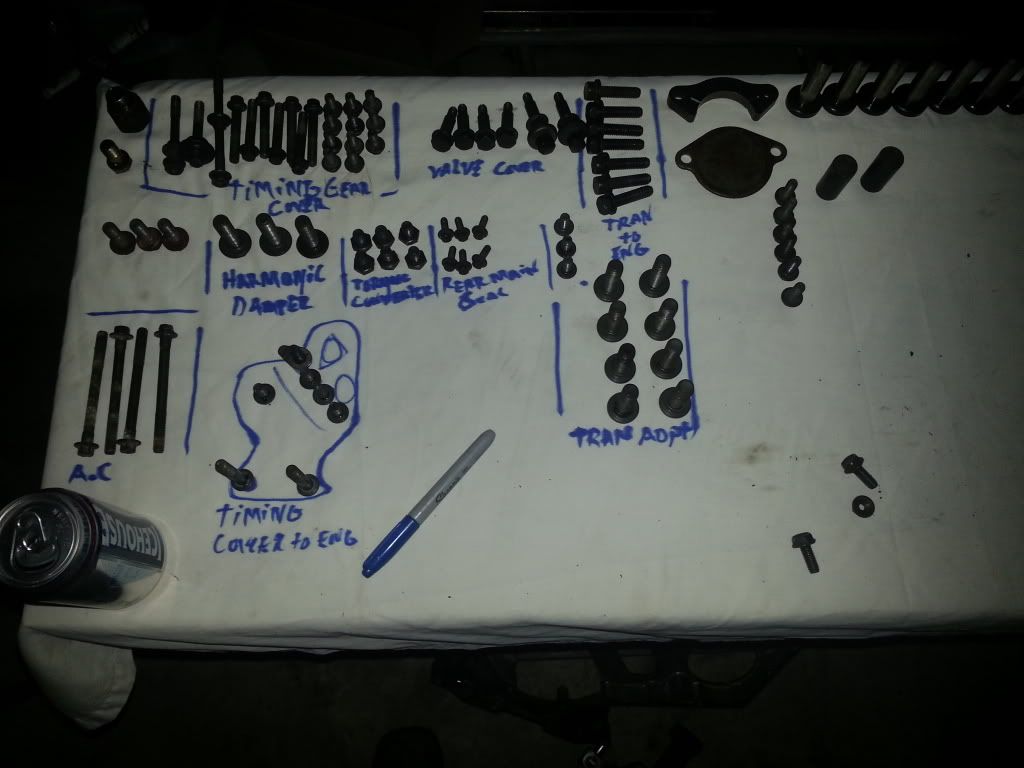

Postby hager » Tue May 21, 2013 8:02 pm
Imagehere's an update picture

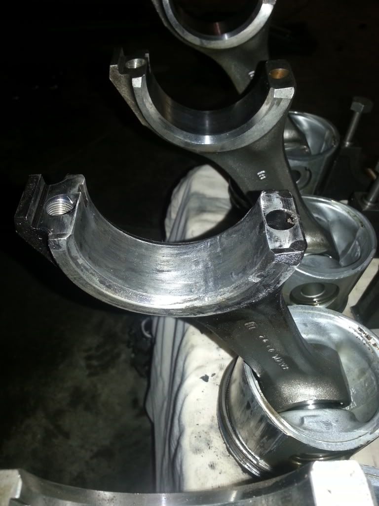

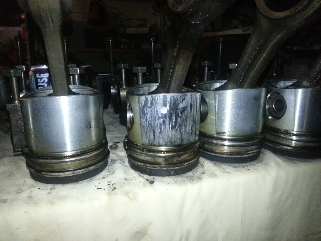

Postby hager » Tue May 21, 2013 8:07 pm
