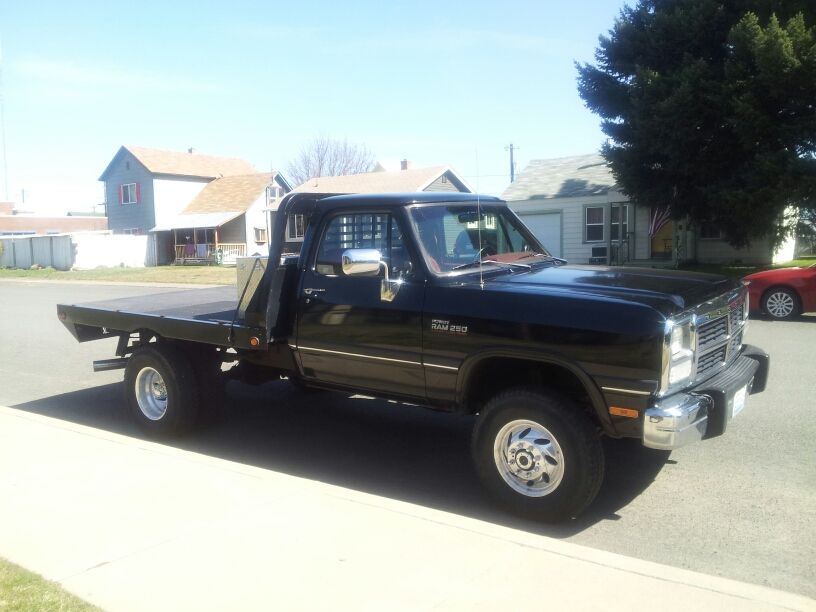

Postby benbo30 » Thu Mar 28, 2013 7:49 pm
here is the truck ... one clean 1st gen

Postby dazedandconfused » Fri Mar 29, 2013 2:14 am
Now that is one sexy truck.

Postby bmoeller » Sat Mar 30, 2013 7:03 pm
Not a fan of the rims, but it's a purdy truck! :D

Postby RCCUMMINS89 » Sat Mar 30, 2013 7:17 pm
I likes it.

Postby peobryant » Tue Apr 02, 2013 2:29 am
benbo30 wrote:here is the truck ... one clean 1st gen
Great looking truck.
