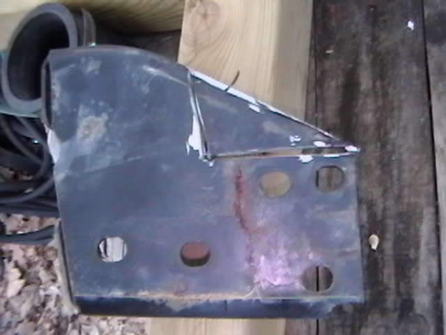

Postby Mark Nixon » Sat Oct 24, 2009 7:17 pm
'91-'93 (LE) use a frame extension bracket, anything else does not.
I will have pics up momentarily to illustrate.
Postby Mark Nixon » Sat Oct 24, 2009 7:37 pm
From what I have seen, these are on LE bumpers, but I honestly haven't paid attention to the few non-LE trucks I have seen to say if they have them or not, but it SEEMS like the non-LE trucks use the '90 style bumper.
Front bumper attached, wheel side:
Frame w/o bumper w/frame extension, wheel side:
Back side of frame w/frame extension:
With all of this, I did notice that my '90 C&C truck also has some other brackets that are designed to re-inforce the frame where the bumper mounts, which most other '90s I have seen DON'T have.
Postby Richie O » Sun Oct 25, 2009 6:21 am
Here is a pic of my 89 LE's bumper mount. The cut in it is where I had to relieve it for my powerstroke cooler to fit.
Postby Mark Nixon » Sun Oct 25, 2009 7:48 am
To the original poster, I do have a spare set of the '91-'93 bumper brackets if you end up needing some.
Also have a decent complete LE bumper, too.

Postby dpuckett » Sun Oct 25, 2009 2:55 pm
I think the extensions have more to do with the grille design than the bumper itself.
The plain bumper should bolt onto the 93 brackets.
