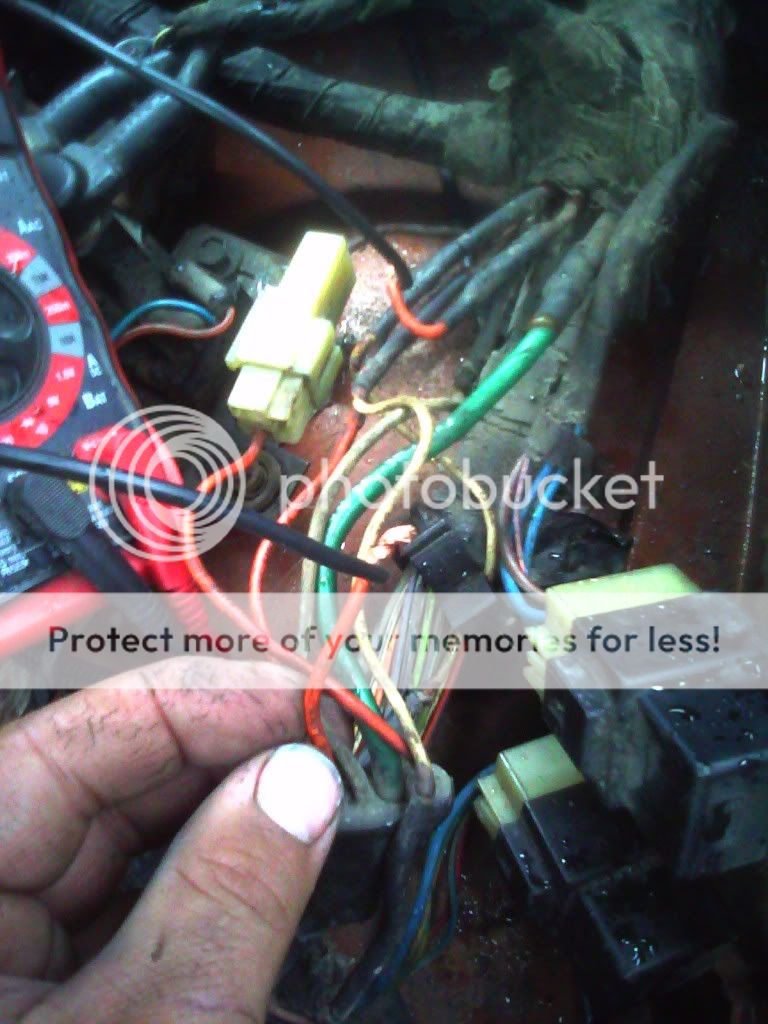

Well fighting rain drops I went out and looked at a few things. Grounds weren't attached at fire wall so attached them and still nothing. Pulled bulkhead plug again and started testing for voltage. I grounded at the battery and probed each pin. Only one pin had power at all and it was 12Vs.
This is that Orange wire that was unhooked when I put it back it. This wire was just twisted together before.
