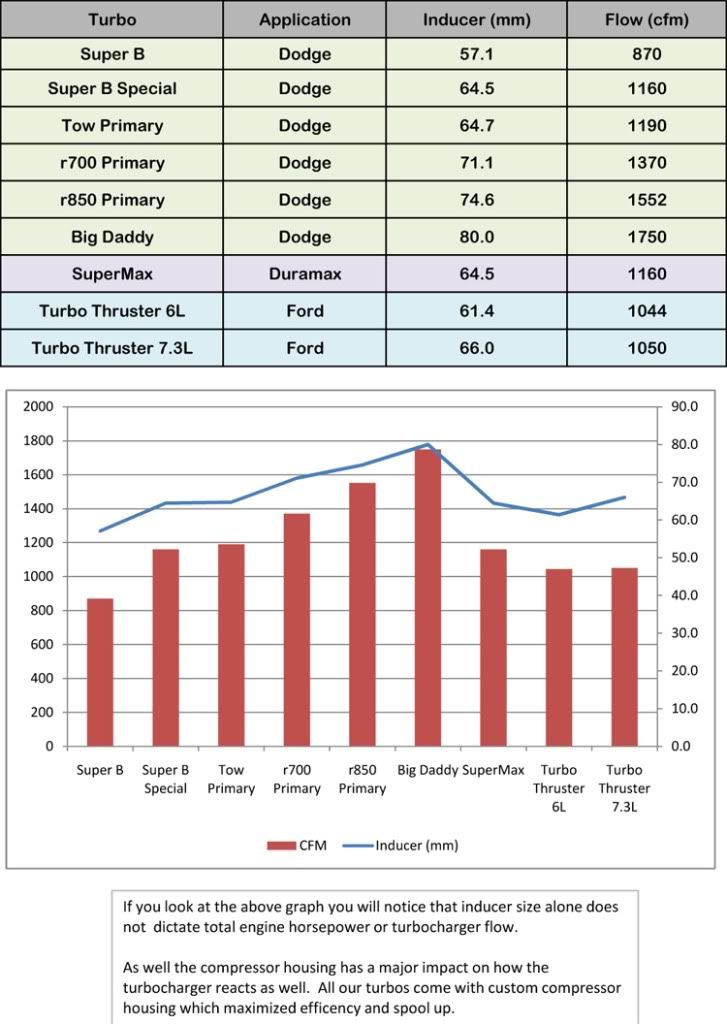

I just ordered my 5X16 vco's and now I need to order my turbo. Need some help deciding on a turbo for some towing lots of playing and streetable power. 93 W250.

Super B special will cool more power. I have 300 at the wheels in my 89 with a 57mm ( super b size ) S300. Its about the limit for that charger. It gets to 1400.

Yeah, Im not sure that the special is right for me either though. I dont want a laggy turbo, nor do I want a ton of heat.
Anyone run a special on a VE motor with a comparable size injector?

Check for sure, but I think the enty level Super B Special is a 62/71/14. You can also go with a 64mm and a 66mm wheel, but I would not go above the 62 model. I would also go with the 14cm (.80 ar ) housing. If you keep your timing on the stockish side, spool should be pretty good. The more you advance the timing, the slower the spool.

The super b special is a 64/71/14.

It appears I have got them mixed up with some of the Industrial Injection " Super Phat Shafts ". :oops: O well, so many sizes to choose from.

So, what are everyones recommendations for my set up? Im afraid that the special will be too much turbo and the super b wont be enough.

I think you'll be fine with the special. If it's too laggy for you a cam will help the spoolup.
