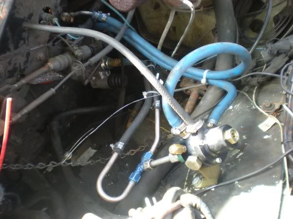

Postby ahale2772 » Sun Jan 24, 2010 12:51 pm
i have a picture of my set up let me see if i canget this to work...
Postby ahale2772 » Sun Jan 24, 2010 12:54 pm
wooo! finally got that to work as u can see its not pretty (whole set up is from parts i found when cleaning the shop) but i have 3/8 parker line running from my tank to the pump then 3/8 after the regulator to a banjo bolt / fitting i found, the boost line runs from a fitting off the side of the head and the bypassed fuel is "t"'ed into my return line works good keeps a steady 15 psi and 20 ish when i really stomp on it
