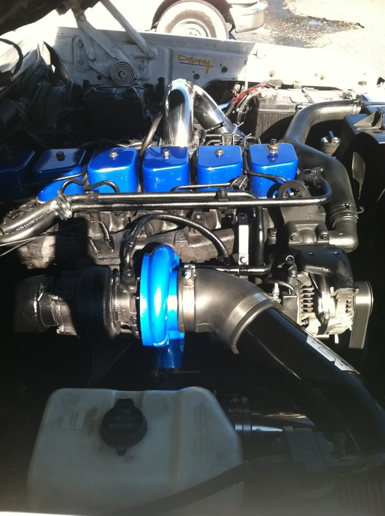

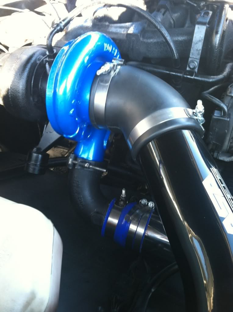

got the bad ass hx35 on and all i can say is holy crap. it lights up super fast and truck now pushes 50ps. it was def worth the 50 plus powder coating i put in it. i love it!!! also it sounds amazing!
also i left w/g unplugged for now. hit 52 at wot for a few secs. love it!!!

Re: Turbo off 97 2500. Hx35
Postby Tacoclaw » Tue Jan 24, 2012 6:05 pm
52psi will probably make for a pretty short lifespan for that HX FWIW.
Might wanna throw the 'gate back on and drill it out if need be to keep it down. Those things are spinning hella fast to get that much PSI built up.
Postby peobryant » Tue Jan 24, 2012 7:44 pm
Tacoclaw wrote:52psi will probably make for a pretty short lifespan for that HX FWIW.
I'll agree with him. Although I'm not quite sure what "hella" means I do know that an HX35 is living on borrowed time if you keep it pushing 50psi. You're way out of it's map range and it's jus blowing hot air after about 30-35psi. Sounds like you need a bigger turbo. :)

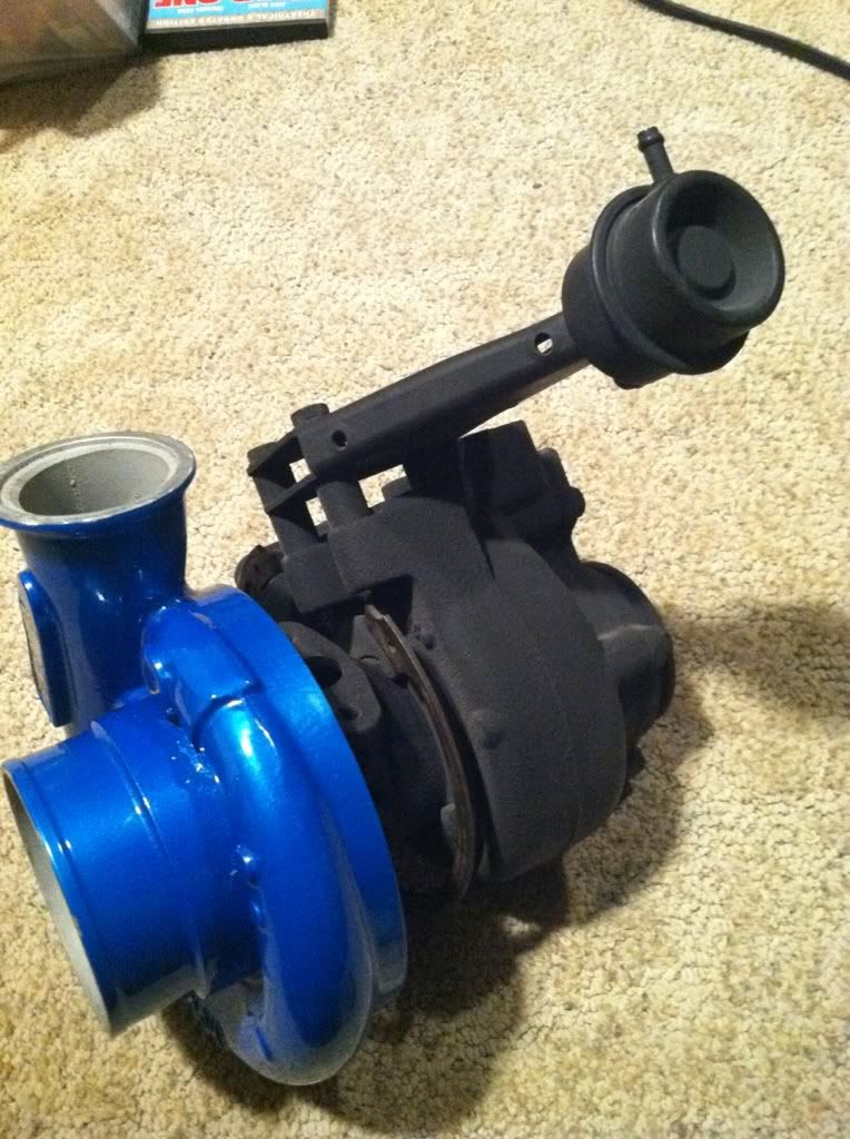

Postby Tacoclaw » Tue Jan 24, 2012 8:53 pm
Sorry, Grandpa, I'll turn my music down. :P
That is a nice looking coating by the way. 8)

Postby oldestof11 » Wed Jan 25, 2012 5:11 am
I was told that at 32psi on the HX35 is around 130k shaft rpms. I can only imagine how fast it is spinning at 50psi. :shock:
