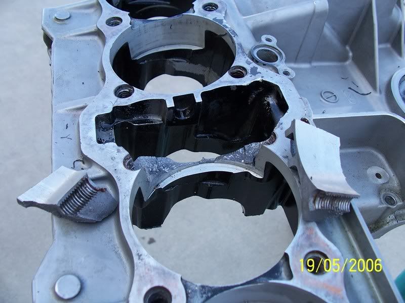

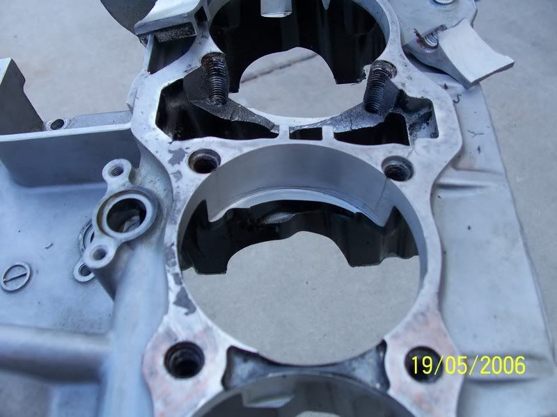

200PSI will work on a tractor motor but not on a 5.9. They aren't heavy enough to take it. Back in the 70's and 80's 3 stage pulling tractors with 3 or 4 turbos were common because of restrictive cylinder heads. As the heads got better most tractors went to a 2 stage 3 charger setup. The 200+psi was not tolerable with the good heads as it made too much cylinder pressure and blew the blocks in half. :roll: If you put 200psi in a 5.9 your block will be in half too!! ;) At 150psi it will look something roughly like this:

Sorry for the image size I didn't realize it would post that big and don't know how to change it.

something like that , a bigger image is way cooler :) .....
how much horsepower roughly did it take to do that ?

About 1500-1600fwhp.

Sissy little motorcycle cases! :shock: :jumpsmile:
Postby TWorline » Wed Mar 12, 2008 6:22 pm
No kidding that looked like aluminum to boot. KTA that is one wild looking block!!! :shock:

Pssst, Tim. Motorcycle cases are aluminum. ;)
