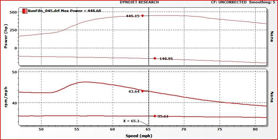

Here's a graph of my 448 hp dyno run, along with the calculated speed vs actual speed (which gives you converter slip rate). As you can see, the higher the engine revs, the more efficient the converter becomes, so rpm is your friend in this case. Unfortunatley with a 14mm head, it isn't, so it's kind of a catch 22 if you ever plan on running one of those.

Postby JQmile » Fri Oct 30, 2009 8:44 pm
The pricey one. I think it is flashing a little because the boost and nitrous hit at the same time. I talked to Goerend and he said my slip rate is about what he'd expect for making power at 2600-2800 rpm.

HP vs mph graphs are weak!! RPM's are what matters!

Postby JQmile » Sun Nov 01, 2009 9:12 am
Nitrous is set on a hobbes switch at 15 psi. At the track I just hit it in the middle of 2nd gear. Should be a different story with some slicks.
Sorry for the MPH graph KTA, I'll go out and buy some software so I can change it to RPM :D
