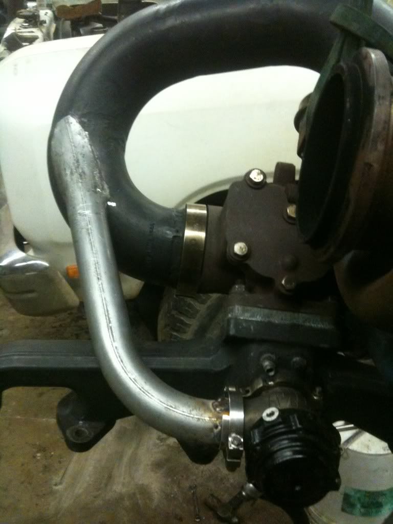

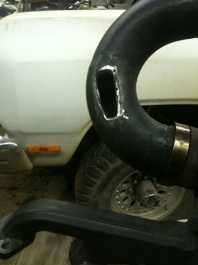

Postby Tacoclaw » Thu Jan 19, 2012 4:45 pm
I doubt I'll get much more "fab" done tonight, so here's some pics of where it's going.
New hole in the hotpipe where the external 'gate will be dumping. I'm not sure what parameters I'm going to use to control it, but it's getting settled in anyways. Hole was cleaned up with a burr after this, but my hands hurt too much to take another pic of it.
Here's the handformed (beat into submission) pipe going to it's new dumpsite:
