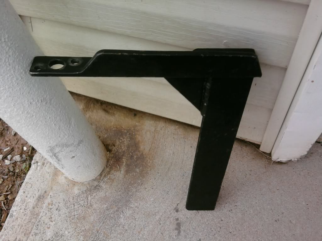

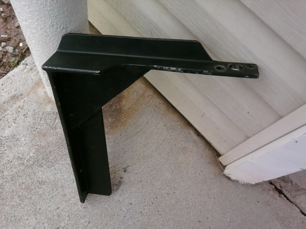

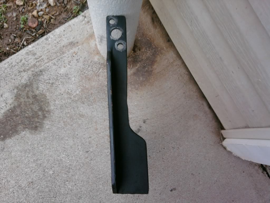

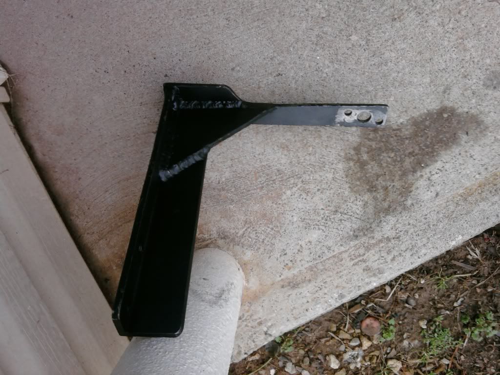

Postby AHineman » Sat Mar 19, 2011 7:34 pm
gobigorgohome wrote:i wanna know how ppl are supporting the bottom trubo.
Here are some better pics of my brace.
My primary brace bolts to the top of the center section of the turbo and to the motor mount. My primary is low, so by bolting it to the top, I had more room for my drain and I could install/remove the brace with the turbo on the truck much easier. I made it out of angle iron and 1/4" plate.
