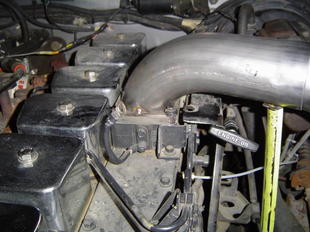

When your searching the Wrecking Yards for parts make sure you pick up this part for the turbo.
http://i125.photobucket.com/albums/p58/ ... C01913.jpg
That Elbow will be required for you intercooler project, and is what Philip
was taking about with the 2 1/2 and 3"Designs.

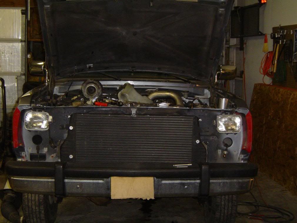

2nt gen intercooler install.
http://i125.photobucket.com/albums/p58/ ... C01702.jpg

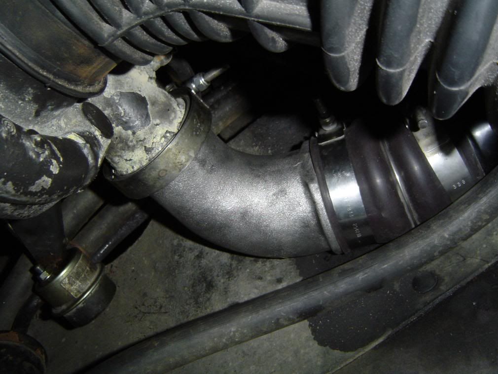

The stock 2nt gen tubes work on the passanger side but the divers side is another story :roll:
How ever Tim (TWorline) On this sight, is helping me with this project.
and is making me one of his big "CoolerTubz."
this is only the beginning............when it's finished it will shine better then them dirty chrome valve covers. :lol: if you look in the previous pic, you can also see it.
http://i125.photobucket.com/albums/p58/ ... C01706.jpg
To learn more about his "CoolerTubz" go down to Member Endeavors, and Click on 3" Stainless Steel Intercooler Tubes For Sale.
