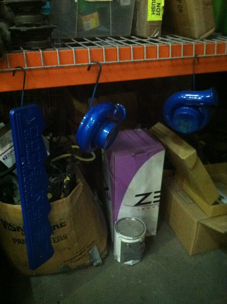

Postby Tsbourne09 » Thu Nov 03, 2011 6:46 am
I will. Its at exotics getting powdercoated. I pick it up next week!

Postby Tsbourne09 » Thu Jan 05, 2012 11:26 pm
Update... Got hx35 housings through 1st stage of coating. Waiting on special clear with metalic in it. Will repost pics when they are finished. Wait untill you see what the valve cover-cover is gunna look like..
