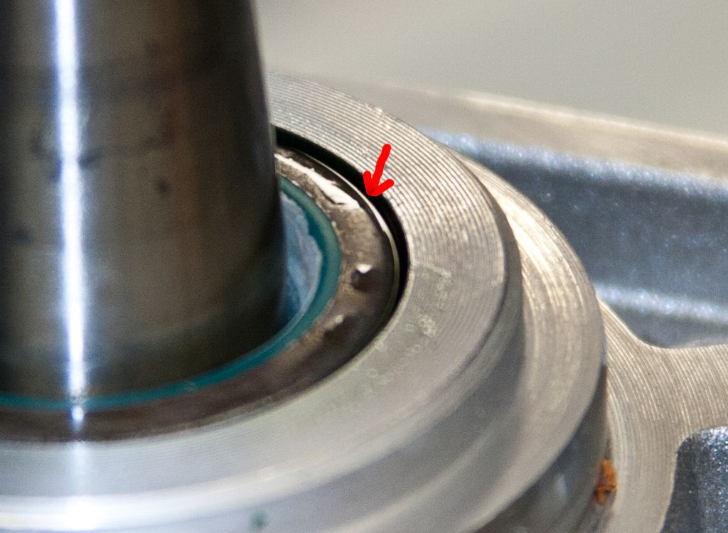

This is just my figuring here, but if you want power/to go fast, there's an excuse to bump timing a tooth. If you're in there, Lock-Tite the seal. You can check the KDP too.

I am about to jump a tooth in the next week or so how should I go about lock righting the seal while I'm in their? and what lock rite should I use?

Postby BC847 » Mon Dec 31, 2012 1:21 pm
If it were my pump, and I wanted to Locktite the seal, I'd use the GREEN product as it is designed to be applied after assembly.
It's my opinion that the other Locktite products (red & blue), being designed to be applied before assembly, are upon installation, wiped away by the interference-fit of the seal.
That being said, there's a problem with my process. The GREEN product is to be applied after the seal is installed. It's designed to "Wick" into the joint. The thing is, who says diesel fuel can't wick out the same joint? If diesel fuel isn't already leaking out, what would assure me the Locktite compound would leak in?
My point is, I think the seal's interference-fit, combined with the sealing product already on the factory seal, are gonna negate any real improvements over the original design. :?
Still, folks have done it, and apparently with good success.
Based on my experience, I don't know that the typical 12mm IP is gonna benefit from an inlet pressure of over 15psig. I'm well over 400hp to the ground with 12psig.
